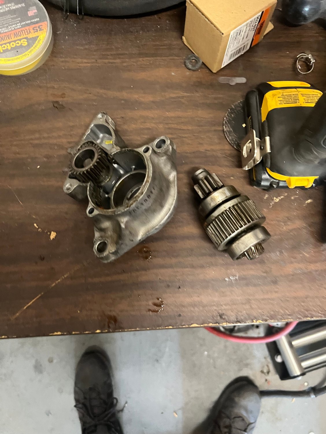

My bendix was frozen up on my starter (been sitting since 06). Tore it apart and got the bendix freed up. Before I put it back together I need to add some grease. What grease do y’all use when going through a starter?

I would use a moly fortified grease that is rated for use in disc brake equipped wheel bearings.
It will be able to take heat without softening or running.
