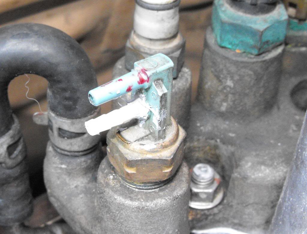

Old Nov 15, 2015 | 06:33 PM
  #40
zytra's Avatar
Joined: Oct 2014
Posts: 134
thanks for all the info guys.
got to replace mine I think - it's been repaired obviously (see pic below).
Engine running a little rich and I have a vacuum leak that is persisting through a brake booster replacement and most vacuum hoses have been replaced. I am thinking (hoping) that'll save my problem. I bought a new one as I figured I may not be able to do a second repair job on mine. But I'm glad I stopped by this thread. I'll buy a 19 mm socket and modify it.
