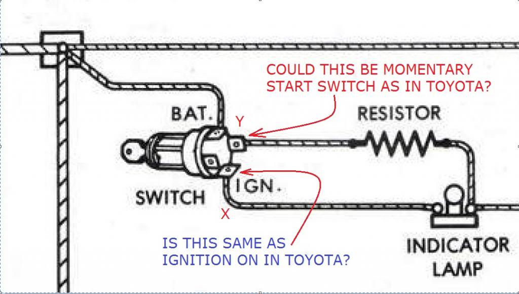

Rustbucket and guys,
I just realized that Buick drawing shows charge light connected to terminal X, and resistor is connected to terminal Y (below)
Does anyone know if X & Y they are actually same electrical point, OR is X the "Ignition ON" and Y the momentary-on "Start" terminal?

Good question. If the resistor wire was connected to the momentary-on circuit, it would still work since it would give the alternator field the initial excitation.
