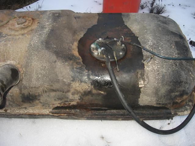

I would try to diagnose myself. I just went through this process and my tip would be it would be cheaper to buy a new gas tank then to pay a mechanic time to tap and die the screws that broke off the old fuel pump bracket. A new tank comes with the proper screws and gaskets so it becomes a matter of finding another bracket to put in. I broke the heads off my fuel gauge sender with a pair of pliers in about 5 minutes.
When they did my pump bracket the screws they put in were 2mm longer then the originals. So it leaked after the bracket was replaced.
Check out my fuel gauge sender in the top left corner.
