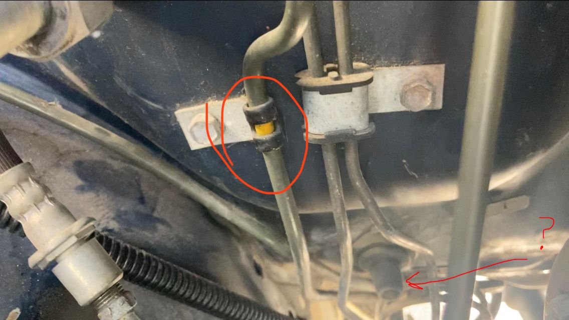

Thanks so much for your reply and I do have an EVAP code! I just checked. Here is another image of the line- the circled hardline is where the first image of the fuel hose is coming from, there is also a strange empty rubber inlet going into the firewall which look like it should have something going into it. Just trying to figure out what to do next.

The mystery hose, marked with a ? in the picture looks like a drain of some sort. Like the drain for the AC system in the cab, or similar. From the look of it, it never has, and never will have, anything plugged into it, unless you put a cork in it for some reason.
Best thing to do is go to the other side, and see if you can find the hose, and trace it to where it goes. I wager you'll conclude the same. It's a drain.

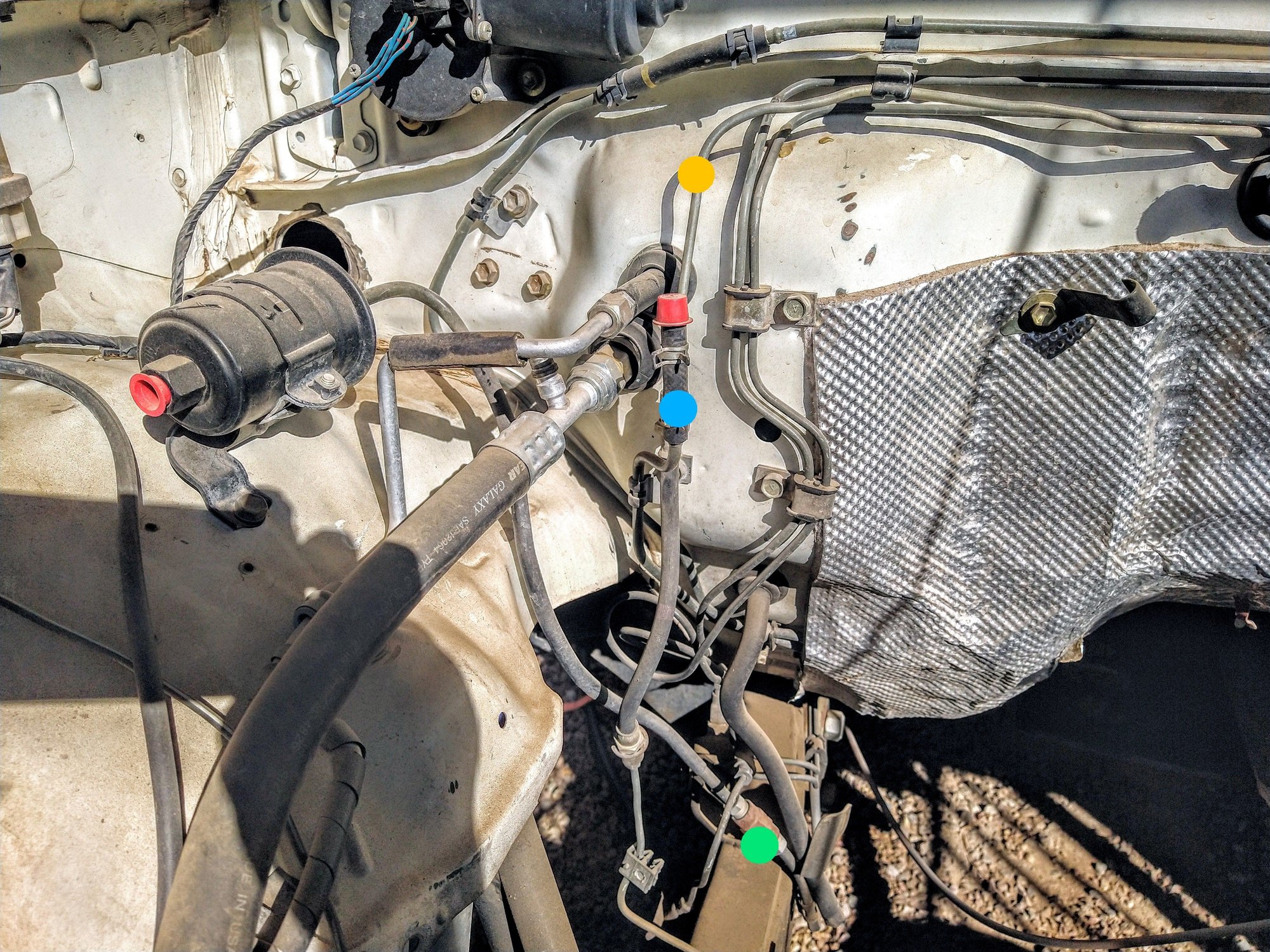

I have an 88 with a 99 3.4. I used the 88 tank and pump. The lines off the tank are like already mentioned. The supply from the pump to the filter and on to the engine. The return from the engine goes to the line that terminates in the tank at the top of the fuel pump cover. (on my tank anyway) The vent line at the tank is more forward at the top of the tank. It goes up to the charcoal canister.
The charcoal canister also has other hoses. One goes to a solenoid valve, another to the air box I think and one goes down and just vents inside the frame. That's how it came off the 99 4Runner donor. I can probably get pics if you need them.

I agree with 2ToyGuy about the rubber grommet. Looks like the A/C condensate drain. My other trucks had a short tube hanging down out of it.

Green Dot is fuel line from the pump. I obviously changed things and put my filter in easy reach. Blue dot is fuel return from engine to tank. Yellow dot is my vent line between tank and the charcoal canister.

AZ you are the man! THANK YOU 🙏! I will compare first thing in the morning
