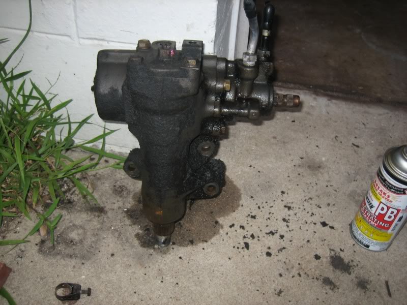

I have an extra leaky but otherwise good one now, after replacing mine during my engine rebuild
I even took the time to purdy-up the junk yard gear box that only had about 120k on it
maybe between the two of our bad ones we can make one good one, sell it as reconditioned, and split the profit!
