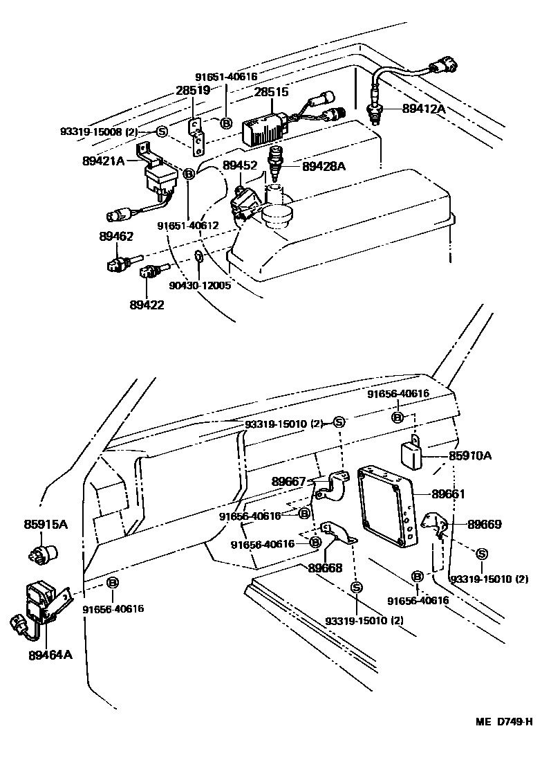

If the cold start injector looks ok then test the sender that controls it.
#89462
