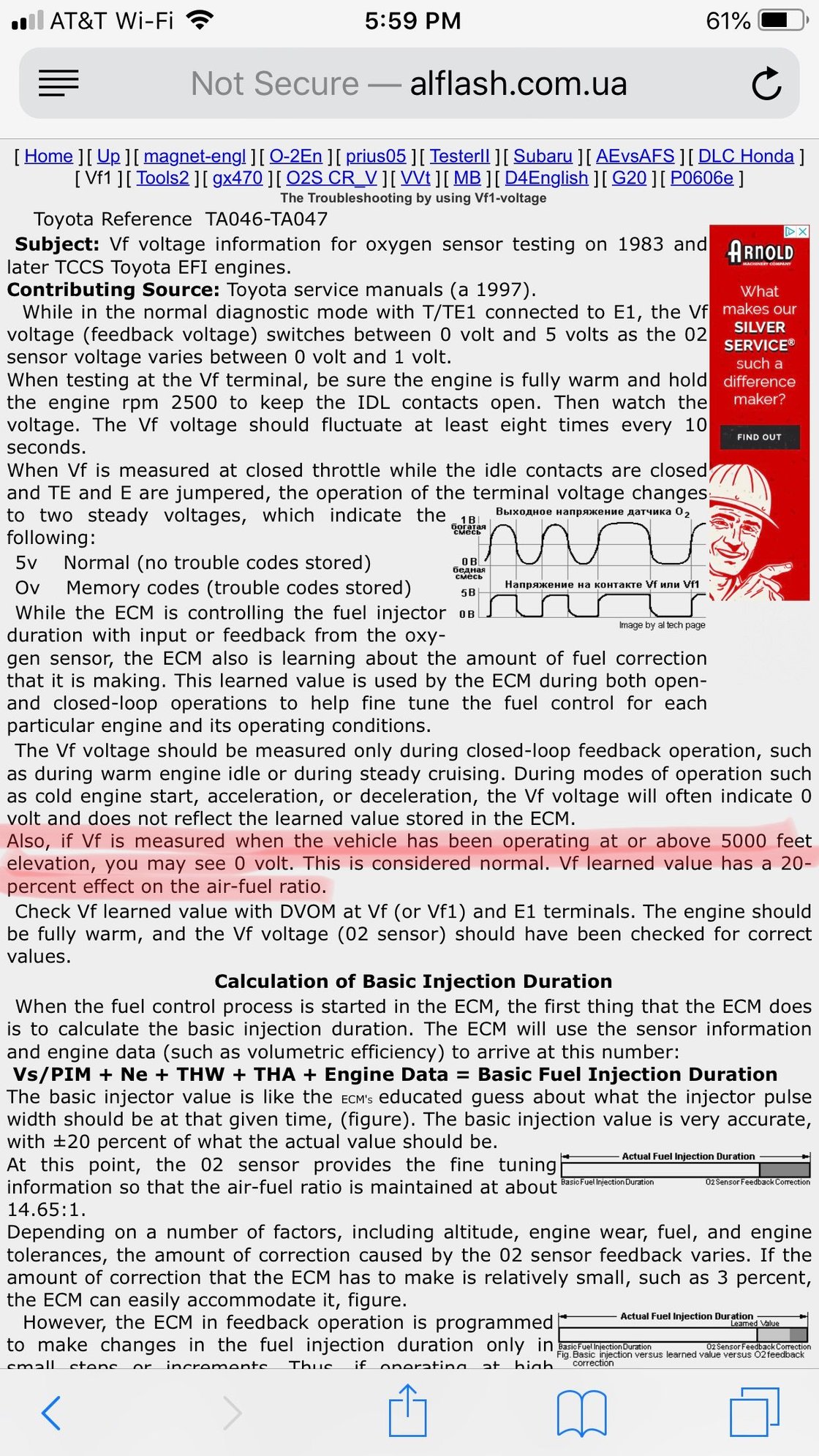

One thing maybe to note is the rich running condition first started when I was driving at altitude (~10,000ft). I live in Golden, CO so 5,700ft
VF1 voltage

Thanks for that about reading 0V at altitude. Makes sense... but now how is the computer supposed to compensate at 5,000ft? Can I figure out if the signal is correct? Or do i have to drive down to the beach... It definitely still runs rich (exhaust smell and terrible gas mileage).
