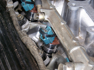

While in the procces of replacing my head gasket on my 3.0, when i unpluged the fuel injector wires all the little clips that plug into the injectors broke. I guess they were just old and brittle. can anyone give me a link to where i can purchase those clips. I dont want to have to buy the whole wireing harness if i can avoid it.

Probably go to a junkyard and slice just those parts off. Or buy the entire harness from the junk pile.

Search around here. There's another thread that has a source for just the connectors themselves.
I'd worry that any junkyard truck would have the same problem. Mine does. I didn't replace mine, though, just stuck 'em back on. If they ever come off, I'll get the connectors new and splice them on.

https://www.yotatech.com/forums/f116...arness-202467/
I tied mine down with some wire.

I used zip ties on mine.

5 of 6 of mine broke and i also used zip ties

thanks guys i will use the zip ties. junk yards wanted $50 for the whole harness and would sell the clips any cheaper.
Thanks though
