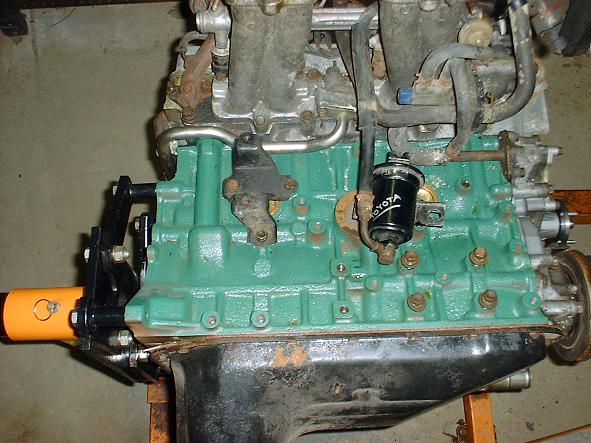

My question is where the bloody hell is the fuel filter on a '86 22RE. I'm in the middle of a lower end rebuild and I cannot remember where the fuel filter is located.
Can anyone help? A photo would be most helpful.

right side of block!!!

Hope this helps..Good Luck

Yup, I know it's on the right side but I can't find any holes on the block that will line up with the holes on the filter and still allow the 'out' line to attach to the 'out' fitting on the filter. My next quest will be to finger out why fuel leaks out of the bottom tube on the charcoal canister - but fuel filter first.

Fingered it out. I went back downstairs and looked at the pile of brackets and found one the does the trick. Now I feel so dumb but I guess there's no way to insert photos here so I can't provide data for the next guy. I was able to attach two photos but I don't know how to show them in the text.
