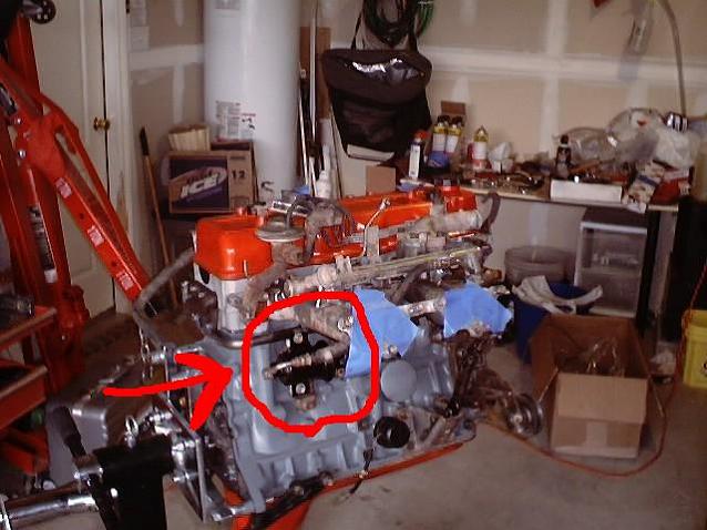

Here it is! Its real easy to change, if the motor is on a stand. Otherwise like these guys said, go in through the passenger wheel well, and break those fittings loose BEFORE you unbolt it from motor, pretty straight foward
