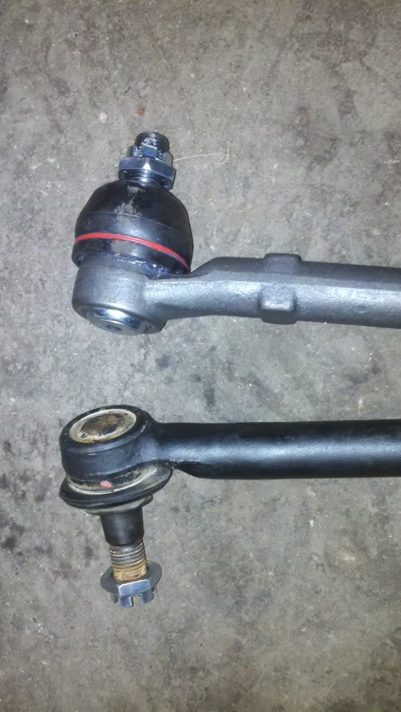

Wanted to add some pictures of the aftermarket TREs vs Deeza.
On the truck, the difference isn't as impressive as they were on the ground before I installed.
What's clear is that where the arms join to the joint section is more robust, the ball is more robust, the construction is generally more robust, the boots are definitely at least twice as thick and are designed to release excess grease around the top seal, and they come with zerks.
I think I noted before, but I reused the old nuts instead of drilling out new holes for cotter pins in the TRE posts. The Deeza were about 1/2 the width of the old ones...
Outer:
Inner:
