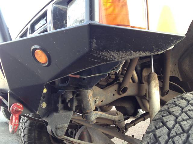

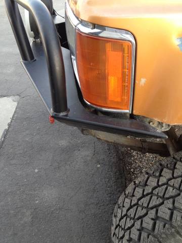

Here are some more pix of that CBI bumper that Nathan from CBI sent me via Email.
Since you are sold on this look.

I like it. I'll probably keep the sides near the corner lights a little more square like the photo of the XJ above. I don't plan to use a winch so it wont stick out as far either and it'll have a flat top.

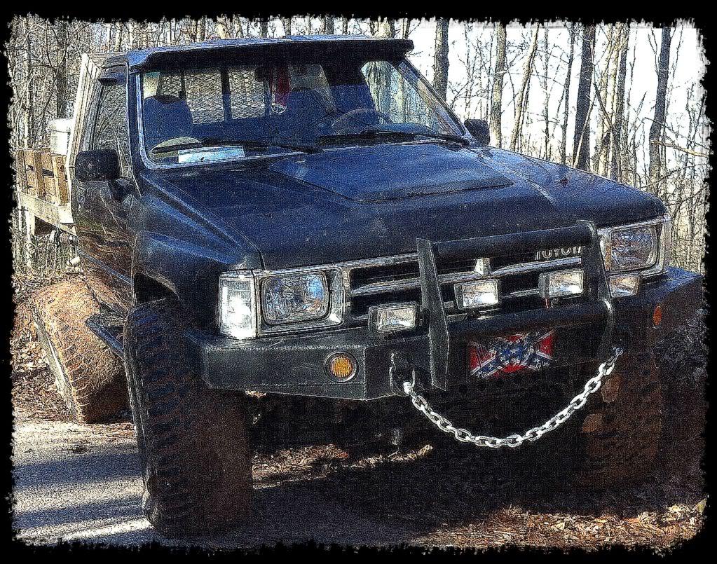

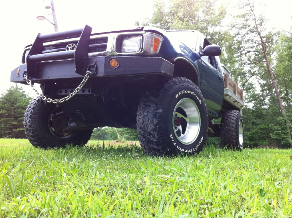

I built this bumper for less then 100.00 bucks. I used 4" and 6" channel and 3/16 plate. I only used a welder and grinder to build it.

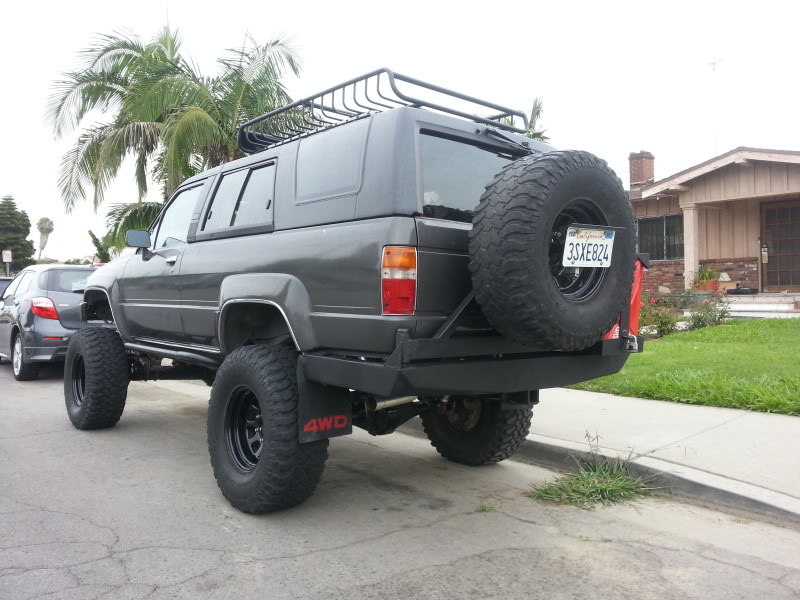

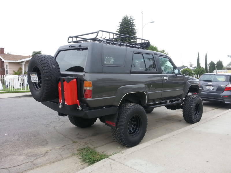

Also be before warned right now. Try to keep it 3/16" plate. I used mosyly 1/4" because I wanted a super hwavy duty bumper for my rear end. And although the bumper looks great the rear end sags even more now then before. That is my only regret. But I'm getting the problem fixed by going 5" lift to 6" lift leaf springs and going from 4" shackles to 6" this weekend trust me I need it haha.
But 3/16" is still thick enough and it is the same thickness that ARB, CBI and WARN bumpers use.
Here is my creation. I know it ain't no front bumper like u wanted but just showing it off. Lol and just so much you kbow this was my very first time ever fabricating anything. Not bad eh? I can't wait to make the front one.
