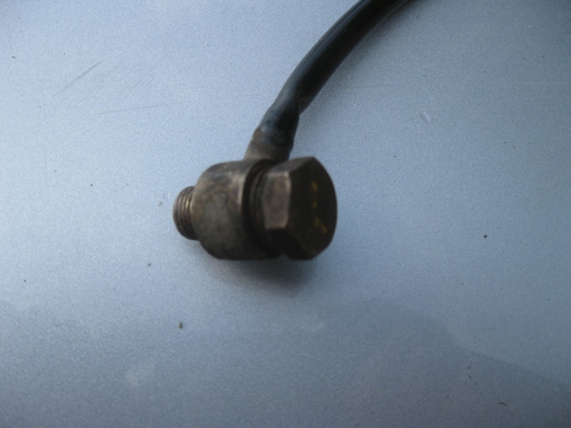

I searched to see if someone already discovered this, but could not find anything.
At a pick/pull, I looked under a '97 LR Discovery and pulled a neat breather extension off the rear which will work for the cramped front diff breather on the 1st gen's. Same British Tapered Pipe Threads. I carried it over to a 4runner in the yard and threaded it to make sure.
It looks like a groove turned into a bleeder bolt, with a nipple and plastic tube. Looked factory to me. Seems like a good solution for anyone who hasn't dropped their diff or has trouble working near the oil pan.

That's pretty cool. Now let's see if we can find a part number.

Hear ya go! http://www.roverparts.com/Parts/FTC2176.cfm

Land rover diff breather extension installed
Good work 'Kid. Here it is installed on front diff, 86 4runner. (Tough to photo.)
