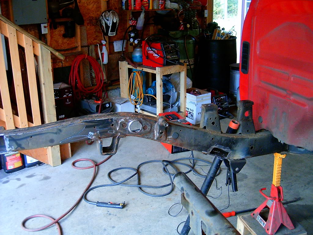

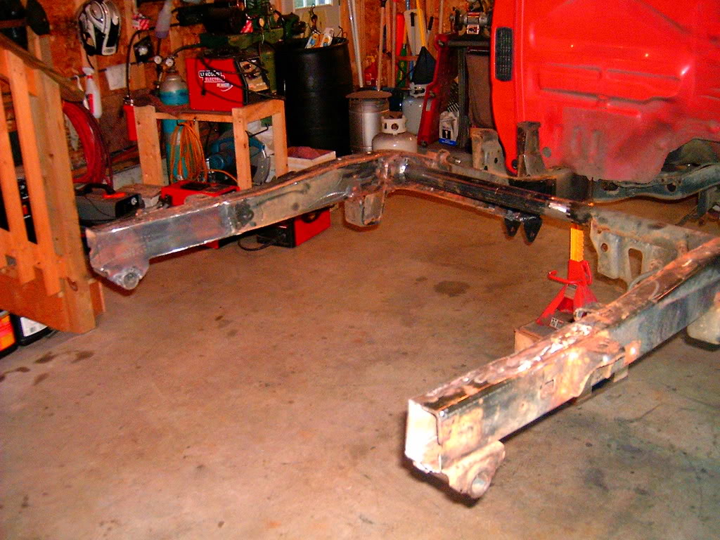

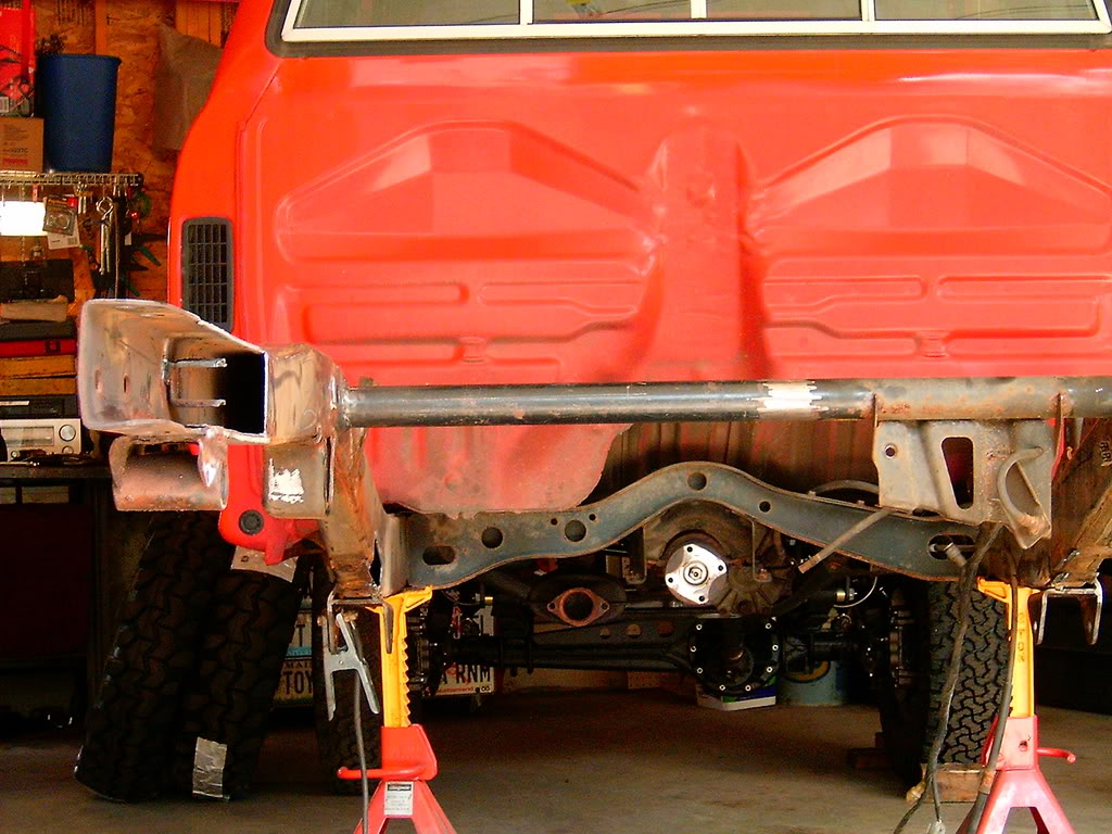

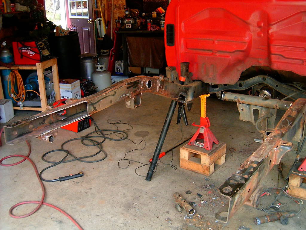

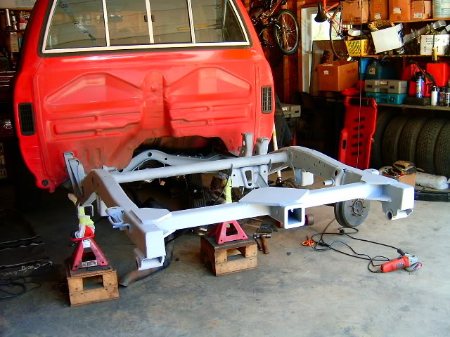

this took me a week by myself working on it after work 3hrs a night.
rear crossmember and tire carrier were beyond repair, inside of frame between rear crossmember was gone, gas tank crossmember was rotted on DS

I think you should fix it.
