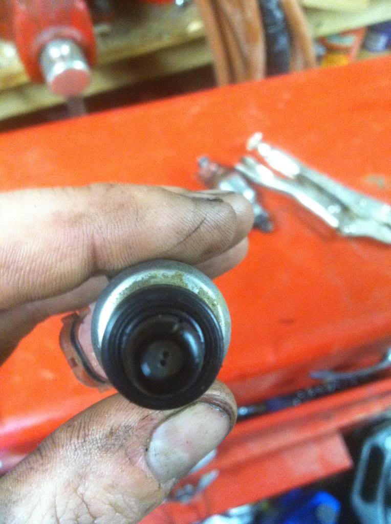

Old 2 hole injectors. Big ugly holes.

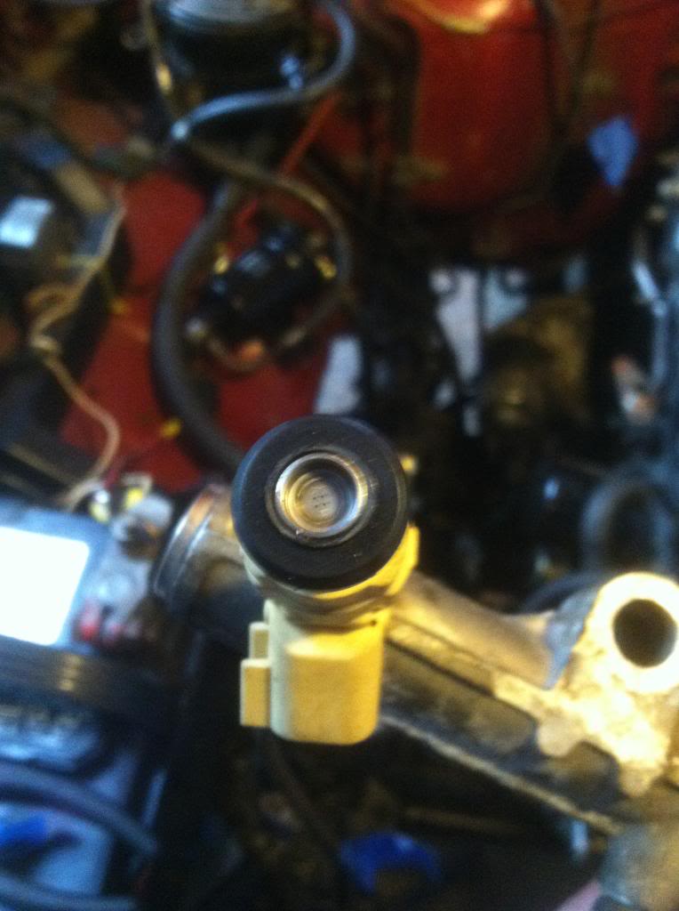

New 4 hole injectors. Wow liquid would be hard pressed to get through there looks like just vapor can pass

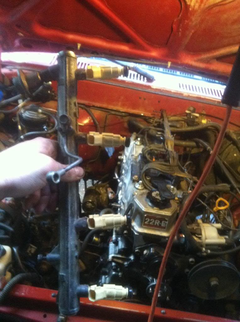

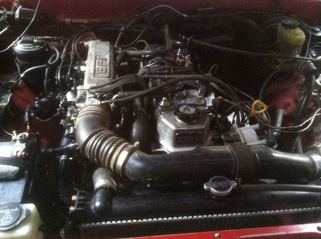

Disconnected the negative battery cable. Pulled the air intake, drained and pulled the radiator & thermostat. I pulled the fan as well just for ease of wokingbecause when i looked inside the throttle body it looked like tar it was time for a cleaning while im in there Pulled throttle cable, marked and disconnected vacume hoses and such. Take pictures as you go unless you really know your way around those vacume lines. Ok to R&R the injectors I believe you only have to pull the plenum off but I am cleaning so went deeper. I always bag and label my parts I remove and keep them in groups. You may have your on way this just works for me. Take lots of pictures as you go. They will help if you have questions during reassembly. Unbolt your egr if equipped pull the 9 bolts holding on your plenum (noting where those wires are grounded and remembering to put them back there). It should be free to lift up off. I might have missed something so correct my if I'm wrong. With the plenum off the fuel rail is exposed and you can see your 4 tired injectors. Unhook and label your injector wires. Be careful these are 20+ year old wires. Remove the banjo bolt, 19mm i think, from the fuel rail (caution if your fuel system is still pressurized this will spray a bit of fuel. So I would at least wear safety glasses and probably try to shield/catch it with a towel. After that bolt is removed there is a small 10mm bolt securing the supply line to the rail pull this and get the line out of the way. Now you can get to the 2 12mm bolts holding down the fuel rail. Once those are out The fuel rail is just resting on 2 sleaves and your injectors. Gently lift and pll the fuel rail off. You injectors should come with it (mine did at least). Be careful one you pull it loose your injectors are ow just pressure fit in the fuel rail held in by 20 year old rubber.

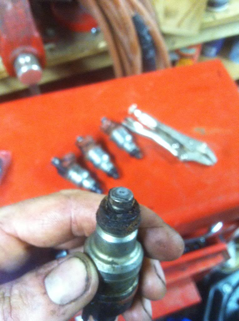

Old rubber

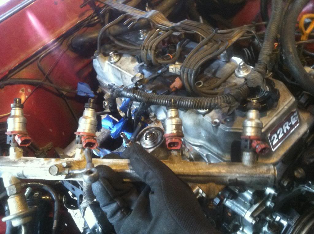

Now get over a work bench or something and slowly and gently twist back and fourth the old injectors and pull them out. Once all 4 were out I put a little dab of fuel in the o rings for lube and carefully inserted them in to the fuel rail. Go straight in and twist back&fourth to get the new ones in. Don't force it. If it doesnt twist when there in you probably buggered an o ring an need to pull it back out. At least that's what every thing I read said. These injectors went in like butter snug secure might have something to do with the double o ring unlike Toyotas single o ring.
Just like new

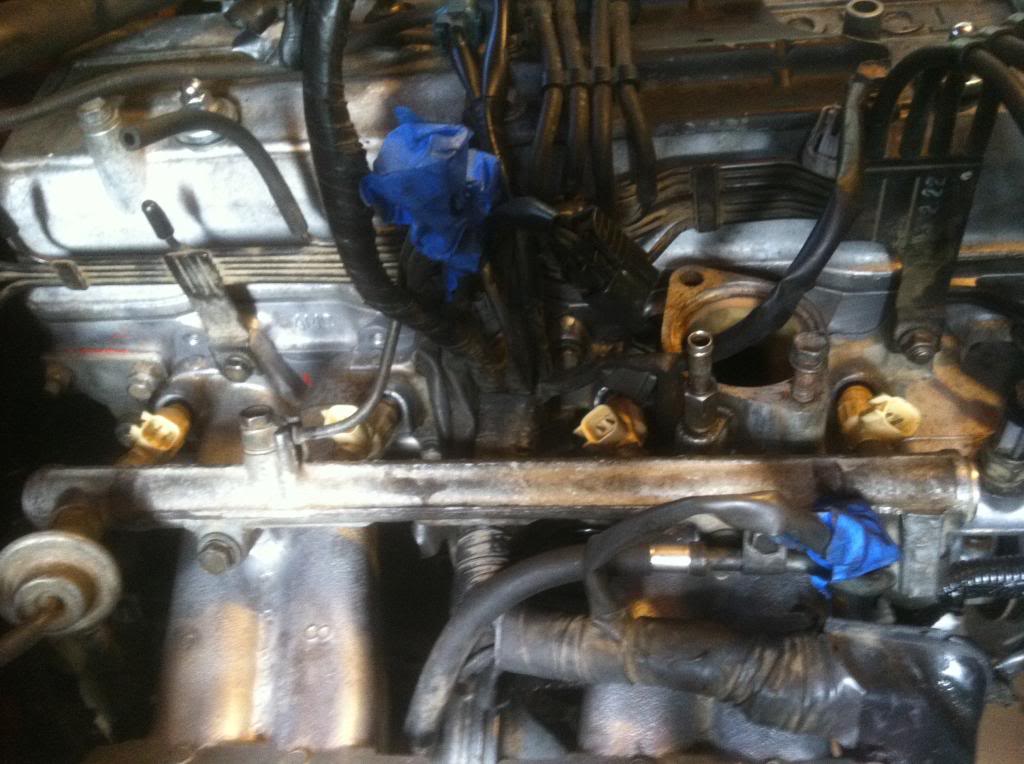

After I got that cleaned up I reattached my intake manifold. Then carefully lined up my injectors, now mounted in the fuel rail, to their appropriate location and wiggled them in till the fuel rail sat in the sleaves. All my injectors turn smoothly (last real chance to check). Reinstalled the 2 12mm bolts holding the fuel rail down and torqued to 14 foot pounds I think. Installed the 10mm securing bolt for the fuel supply line and put the banjo bolt back in the supply line to fuel rail connection.

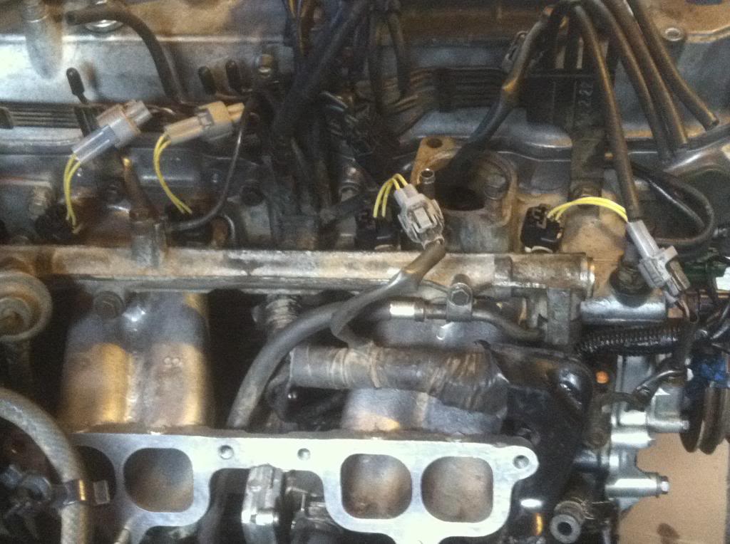

Make sure you hook up your adapter wires to your injectors. Name:  2D5B92D9-DC85-4CED-9B55-00C8DCE60C66.jpg
Now connect them to your existing injector plugs that you labeled so you wouldn't get the in the wrong order. You did remember to do that right? .Name:  F577A655-06B3-49BC-A58B-5F6B6F153364.jpg

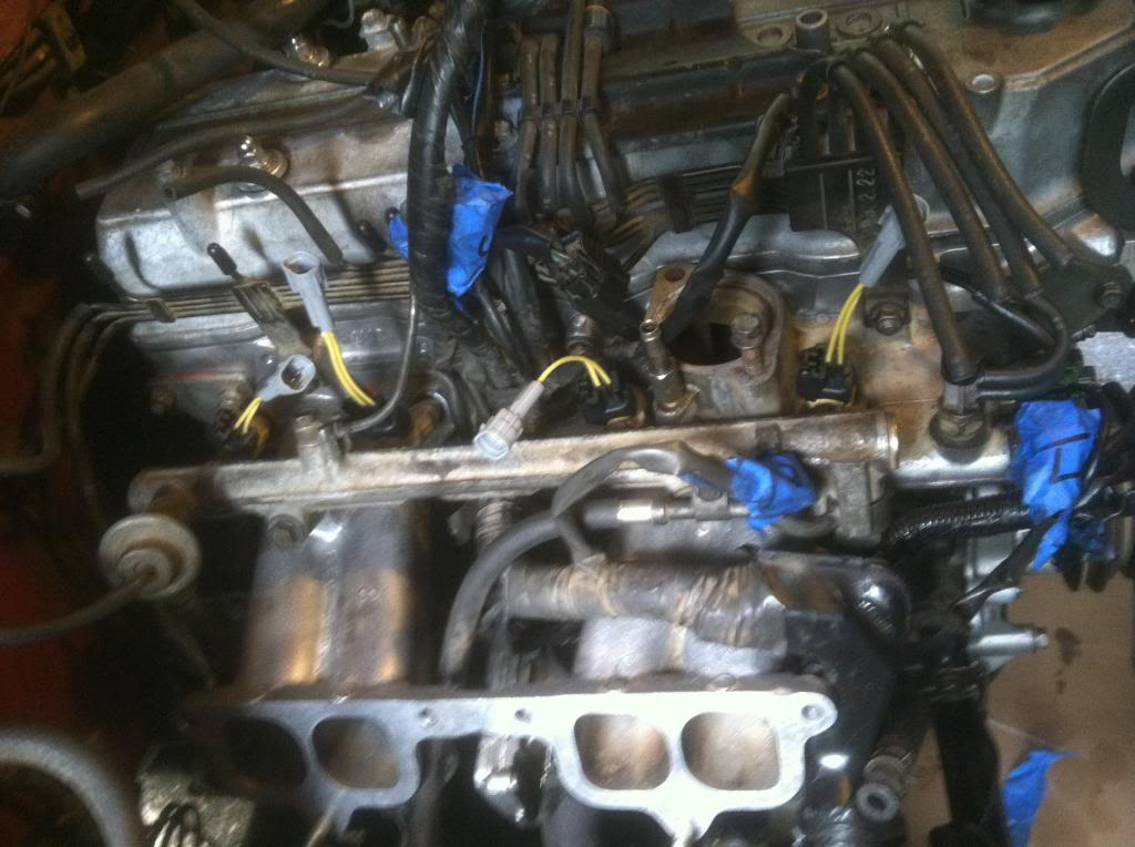

Using a fresh gasket reinstall the plenum and egr (if equipped). Being careful not to forget those grounded wires and the one bolt underneath securing the plenum to the bracing bar that connects to your block. Properly torque the bolts back down. Reinstall your vacume hoses. Aren't you glad you took pictures? Install and reconnect and fill the radiator. Check to make sure you haven't forgotten any hoses or plugs. Connect the negative battery cable. Should be ready to start up.
