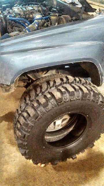

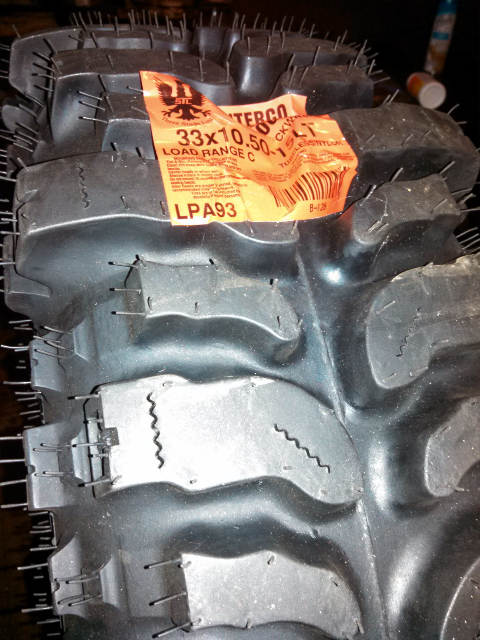

Well I got my tires today. I'm glad I went with the 33s I think it would have been hard to fit the 35s. I ordered some Mickey Thompson classic black wheels but they won't be here until the 22nd.
Gotta love the skinny boggers

From what I've read the ifs trucks can fit a slightly bigger tire in the front than the solid axle without a lift. I went ahead and orders ball joint spacers and a little longer shackle for the back just in case. I'll be able to make them work.

Yeah I've got the tires in and it looks like I'll have no problem fitting them.
