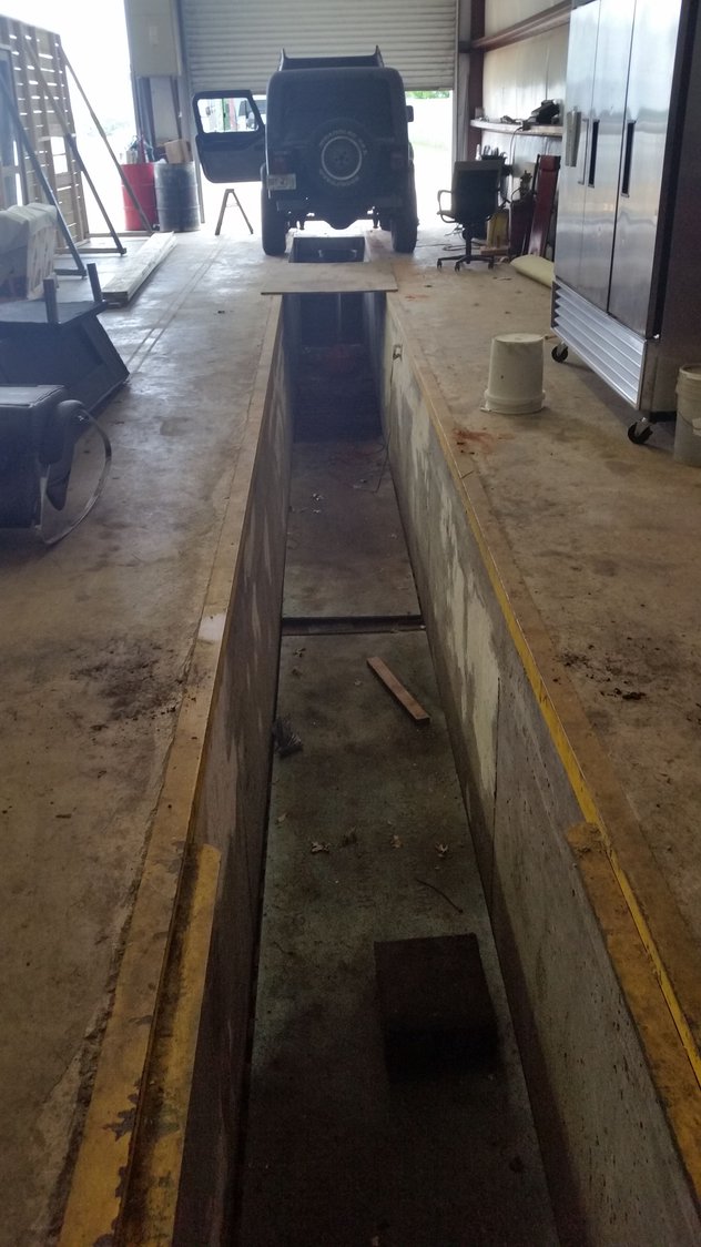

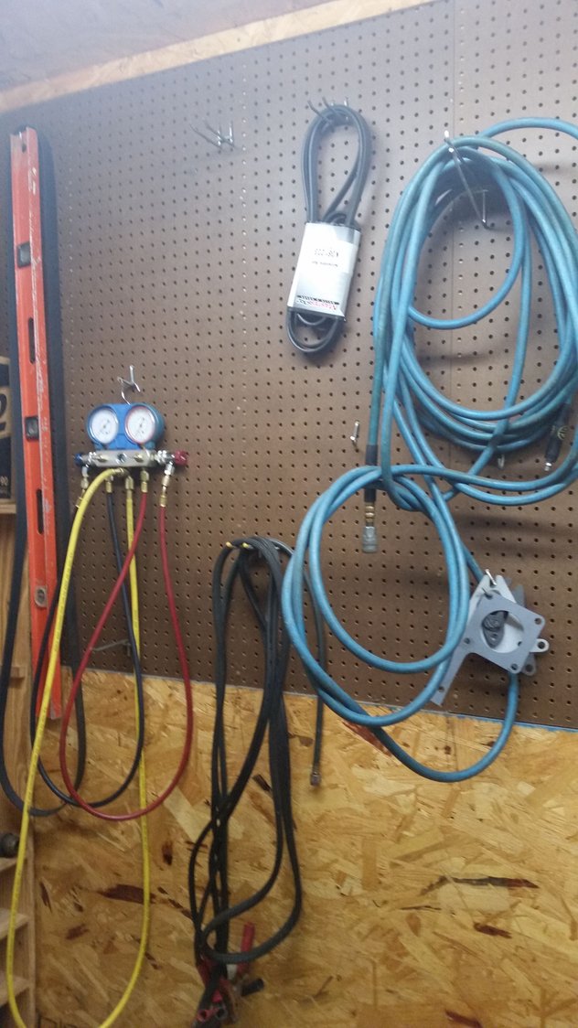

Ah thanks. As I promised I did say I'd post pictures of the shop
