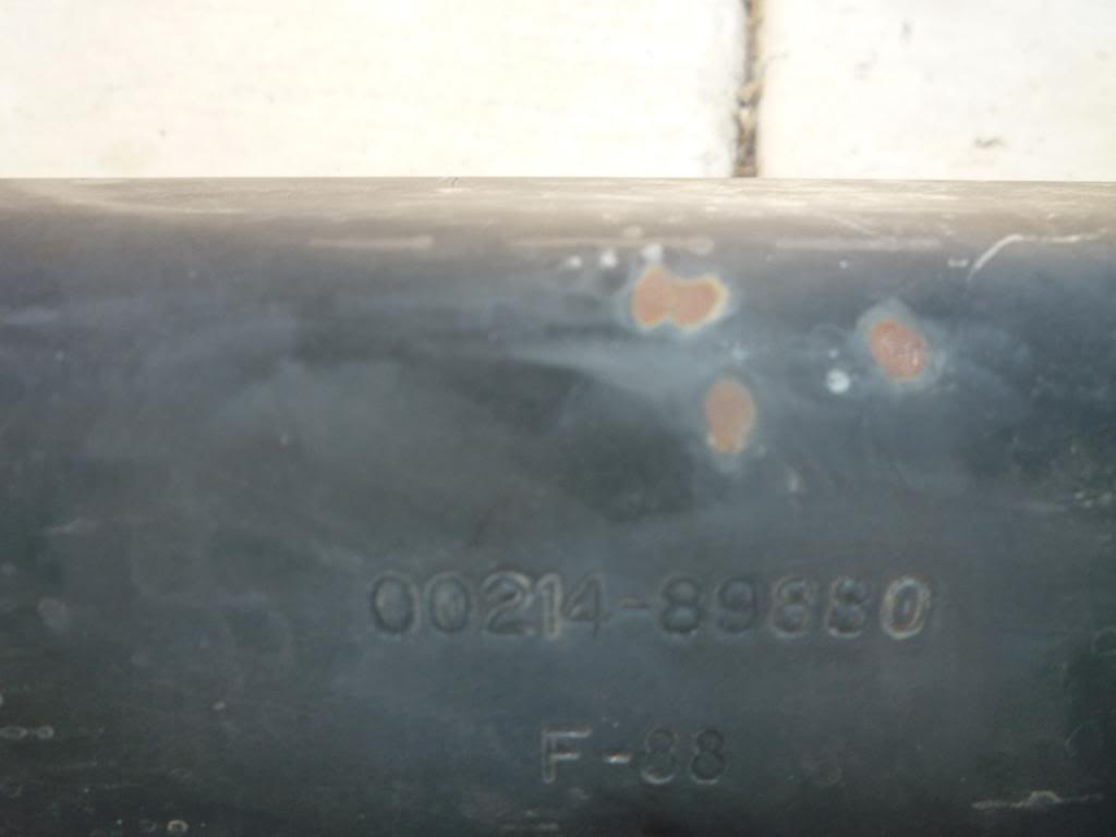

This is the factory hitch that i took off my '87 4runner when i put the tube bumpers on. Name:  P1050487.jpg
Size:  67.3 KB Name:  P1050488.jpg
Size:  79.1 KB Name:  P1050490.jpg
Size:  33.2 KB Name:  P1050491.jpg

Hey maco35, thanks alot man that was really helpful. Are there two mount holes on the brackets that go into the frame? From the pictures i can only see one.
Old Jun 16, 2013 | 04:13 PM
maco35's Avatar
Joined: Feb 2010
Posts: 504
From: L.A. CA.
Yes there are two mount holes on each bracket, is just the angle of the pic. you can't see the other two.
