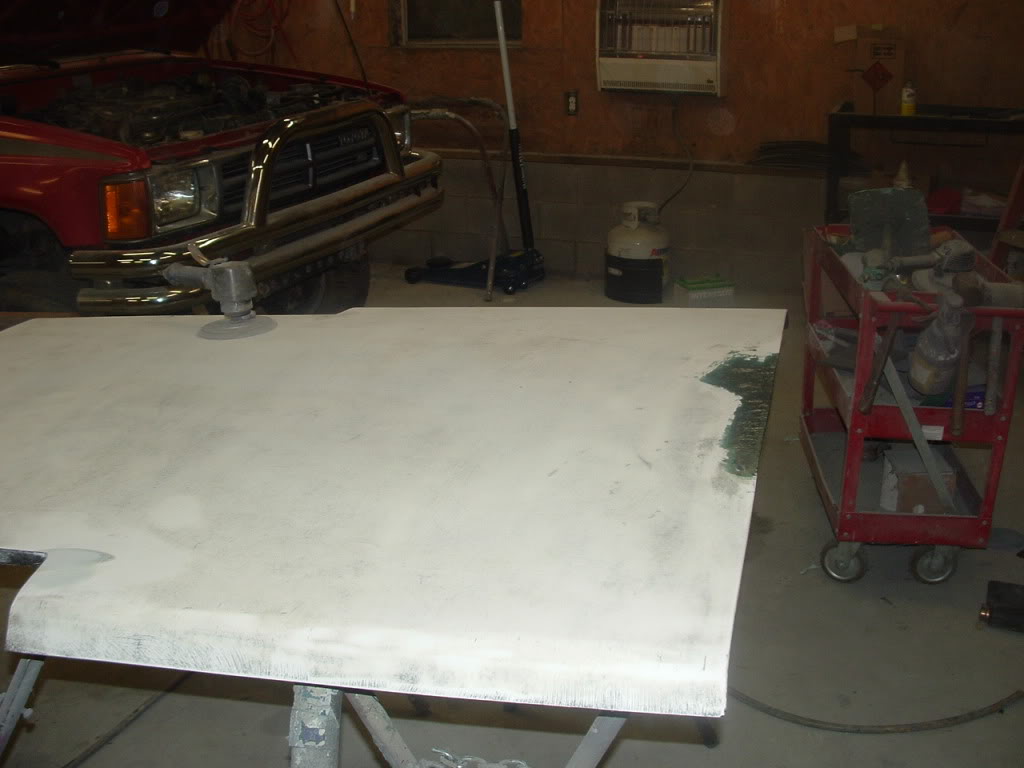

So i decided to fill it with foam ( sprayable insulation) all the way around to fill the gap. BAD IDEA!!!! I ground it down even all the way around and put a layer of bondo on. Once again BAD IDEA!!! Once all said and done the foam along with vibration made the bondo start cracking. I recommend filling it with glass and grinding it down even then a layer of bondo to finish it.. I have painted cars and done bodywork for 25 years, you would think I'd know better than to cheat like that but since it is mine and I was pressed for time I thought "what the heck" lets cheat and see....lol

Did a lil repair on the front where it was damaged from the origional 4runner, You should have seen that one. Yup in the back ground is my next project, 88 3.0, doing a manual tranny swap. I have a top for it as well

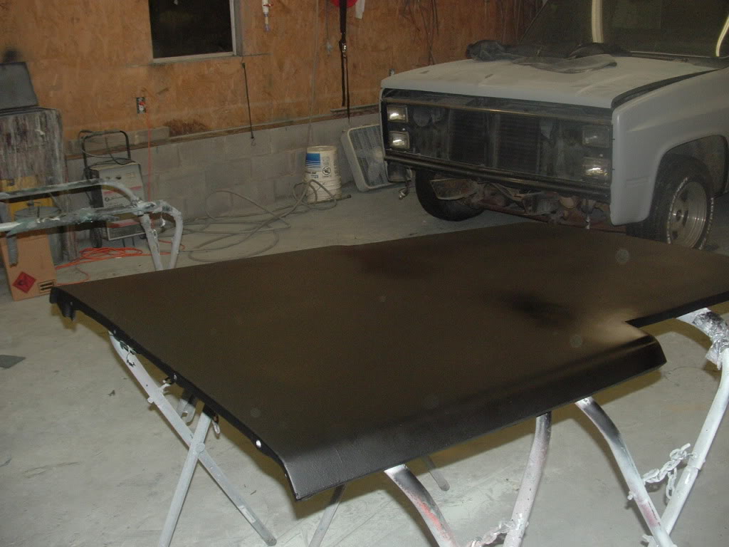

After I got all the repairs and the edges finish sanded smooth with 180 grit I spayed it with black rubber undercoat. You can also use rocker guard or even bedliner spray. It comes from the factory with a little texture, plus the uncercoating or something with texture hides all the repairs with no priming and finish sanding. Then some spray paint if you so desire. I went over it with a satin black for a even finish.

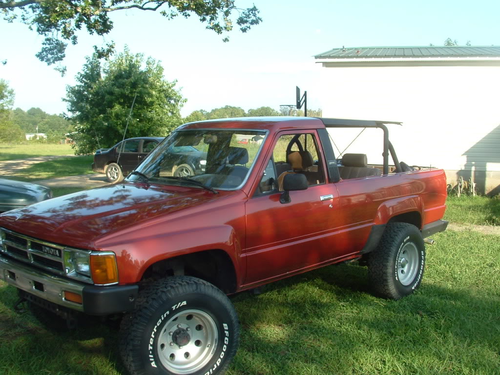

Here it is finished.
I plan on cutting the back off even with the bar, just got in a hurry and forgot it. Oh well maybe i can fix it when I fix the cracking bondo...lol
