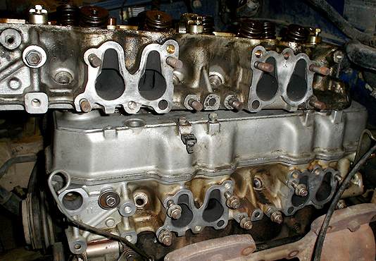

Point to the flaming bolt please
He prolly needs a drivers side pic to do that
You guys drive on the left side of the road dwn there in FL
That is the Dside. Distributor hole check, spark plugs check, exhaust ports and manifold check and check
Think it's an exhaust leak, since all the valve cover "bolts" are on top.
