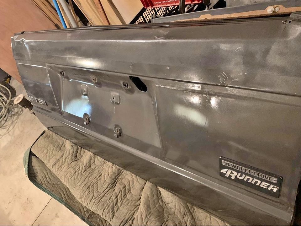

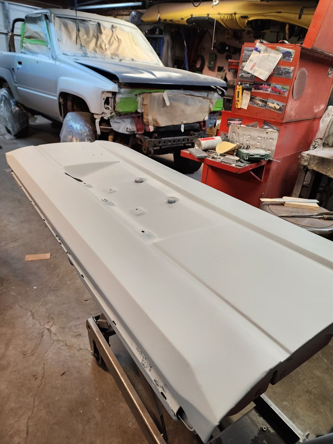

Finally, I'm just about done with the tailgate and getting close on the whole truck. If I can spend the weekend on it, it will be ready for paint. Thinking about a color change now though. Thinking of silver with a black top, black wheels, bumpers, door handles, etc. I need to go through some old threads and decide how I'm going to install and trim out the windshield.

I couldn't get the primer to lay flat (orange peel), so I bought a $15 Harbor Freight paint gun and drilled out the nozzle to 5/64" which is approximately 2mm. That made a world of difference. I have practically no experience with this type of work, so this site and YouTube has been my guide. Thank you to everyone who have given me advice, previous posts, and encouragement.

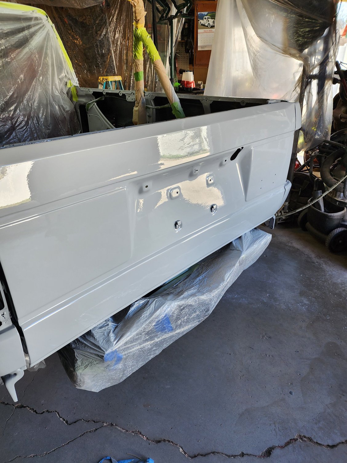

It looks like the weather is finally going to be warm enough to paint without the heat running next week, so I'm finally going to get to paint this thing. I'm sure looking forward to it.

On the old paint job, the clear coat peeled all over it (after 20 years) so I decided to go with a single stage. The top will be a dark gray and the body light gray. I figure the
light gray will help hide many body imperfections. While I tried to do a good job, it's not my profession and my patience only goes so far.

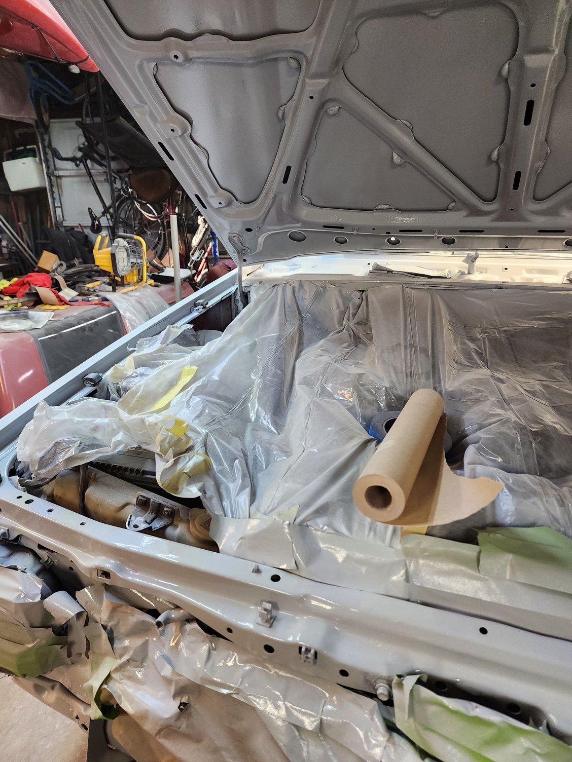

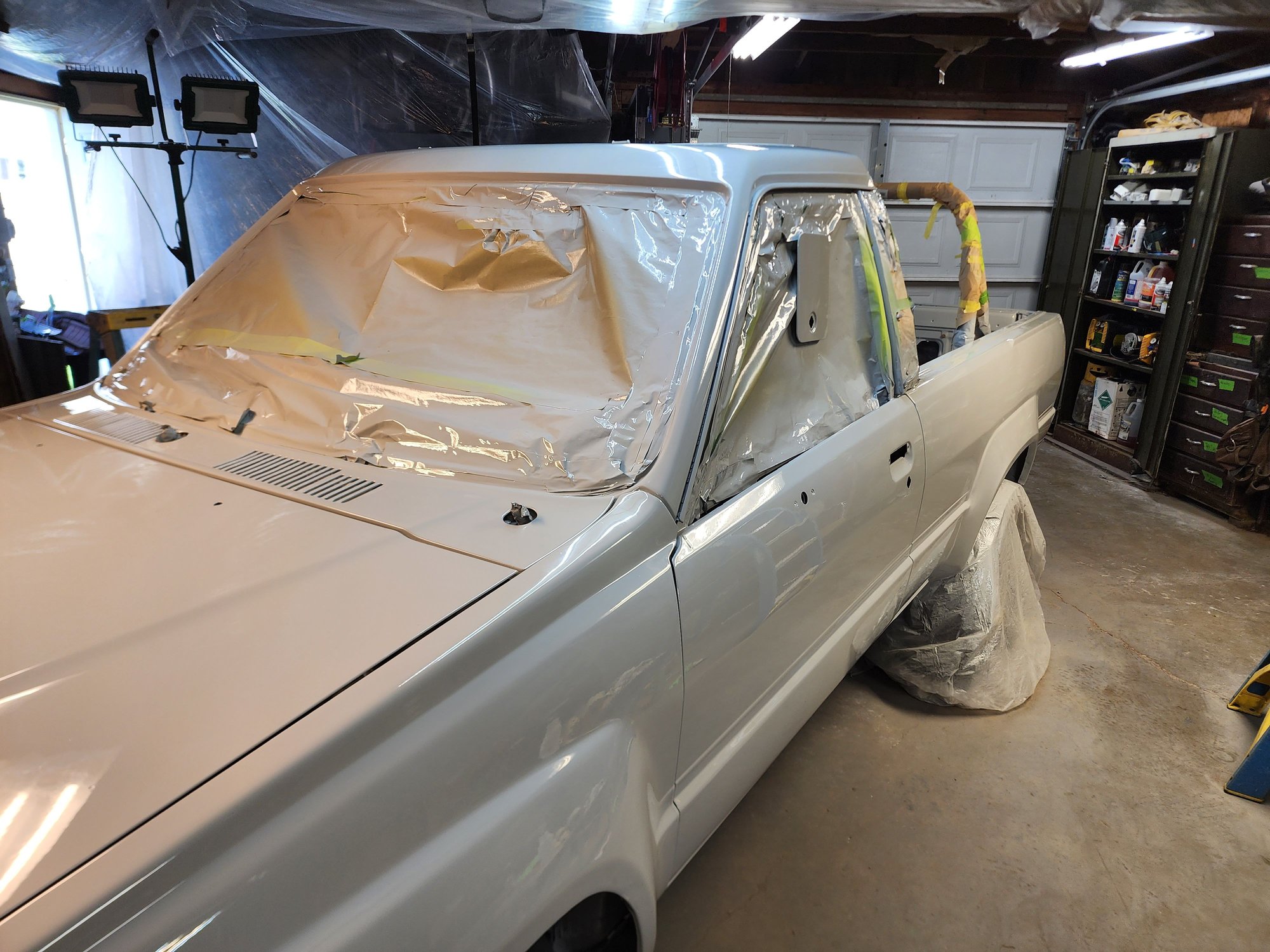

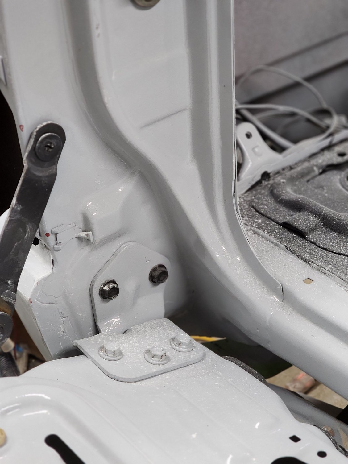

This may show the color better. That area under the tailgate hinge was really time consuming and isn't even visible. Inner and out sheet metal was all rusted away and needed replaced.I must like it though. I'm thinking of pulling in the 82 pickup next winter and painting it. The problem is that I won't want to work out of it with new paint on it. I've already decided to retire the 4runner as a work truck after the paint job.

I have a couple of runs to fix or re-shoot the front fender if I can't sand/buff it out, but overall, I'm happy with how it turned out. I'll post a few more pics after I get it back together

It looks very good!
