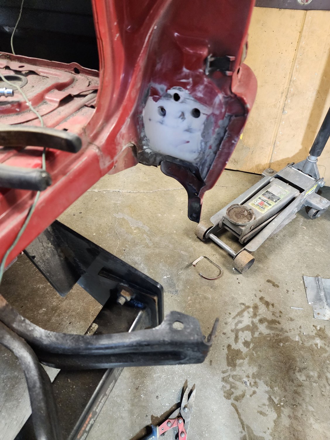

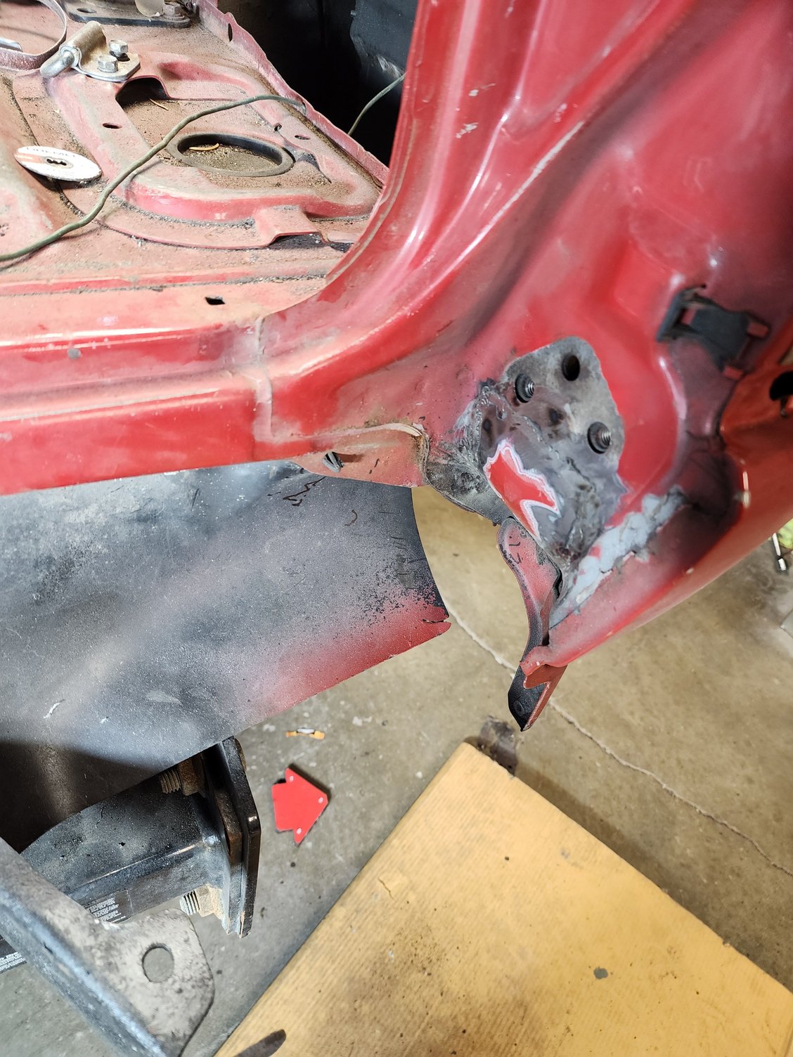

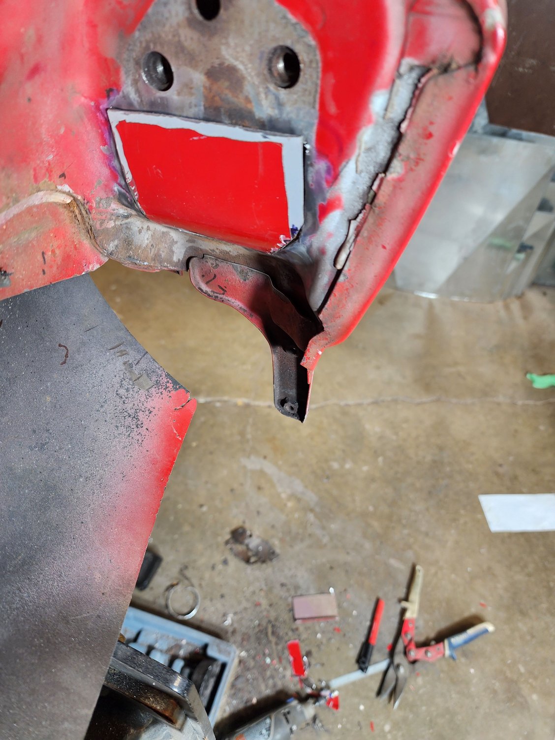

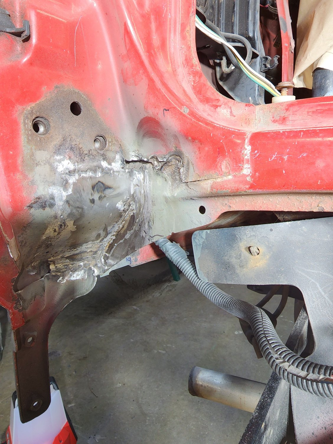

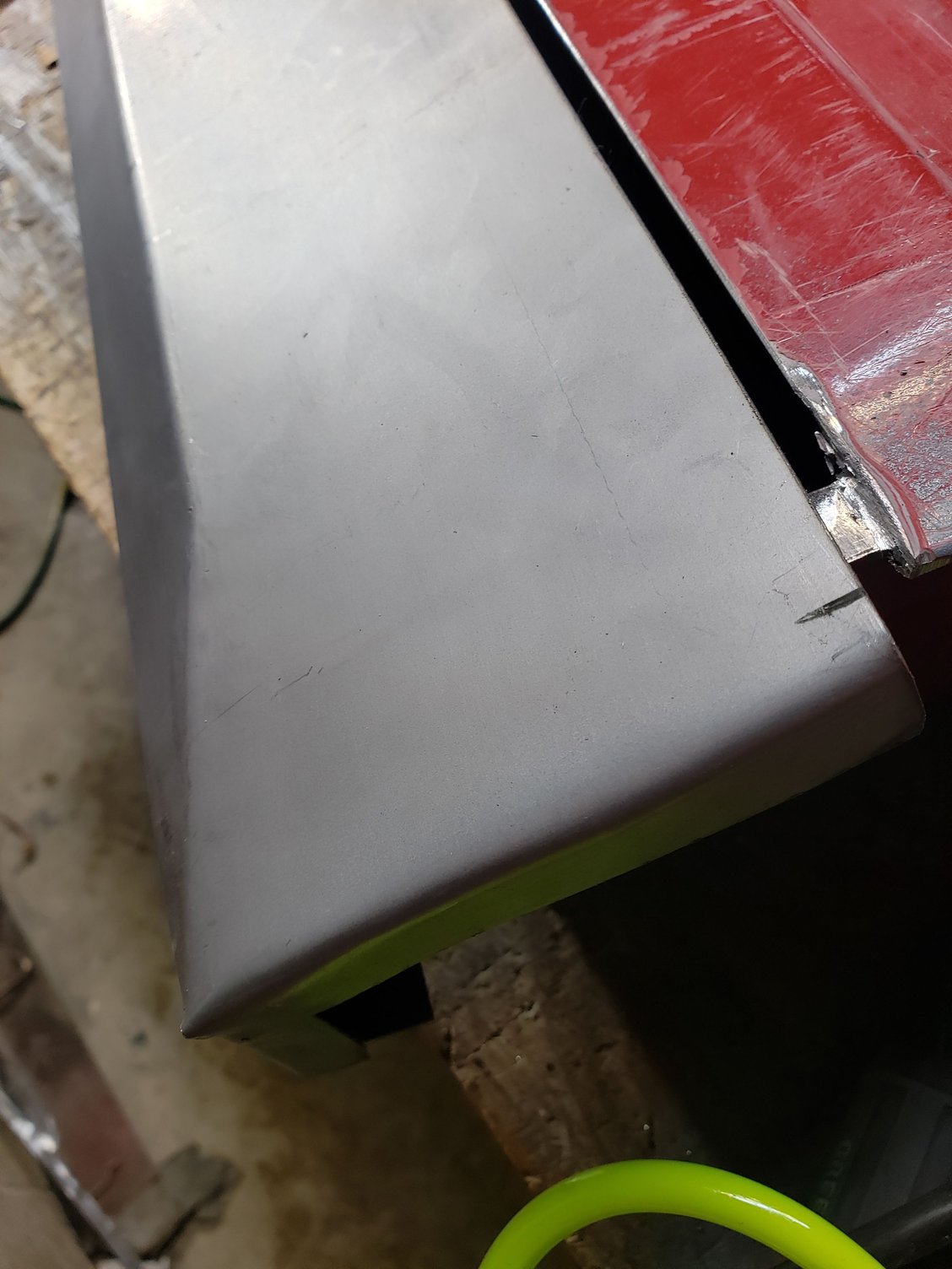

So much for starting on the tailgate. After I got it off, I noticed the driver side inner supports and panel were rotted worse than expected. I welded in a bunch of 16 gauge to reinforce things, then welded 20 gauge to the outer panel to cover it up. The passenger side only needed work on the outer panel.
Inner repair
Not shooting for perfection. Nobody but me will notice here.
So much easier on this side
This time consuming part of fitting pieces
The quickest part.
Close enough for who it's for and where it's located.

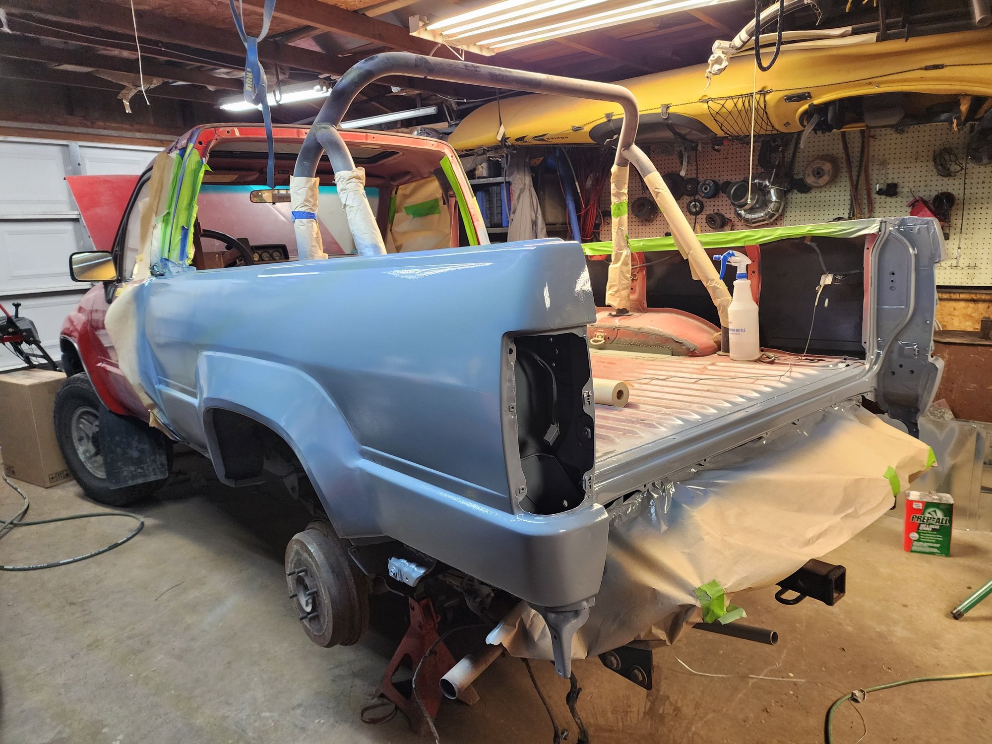

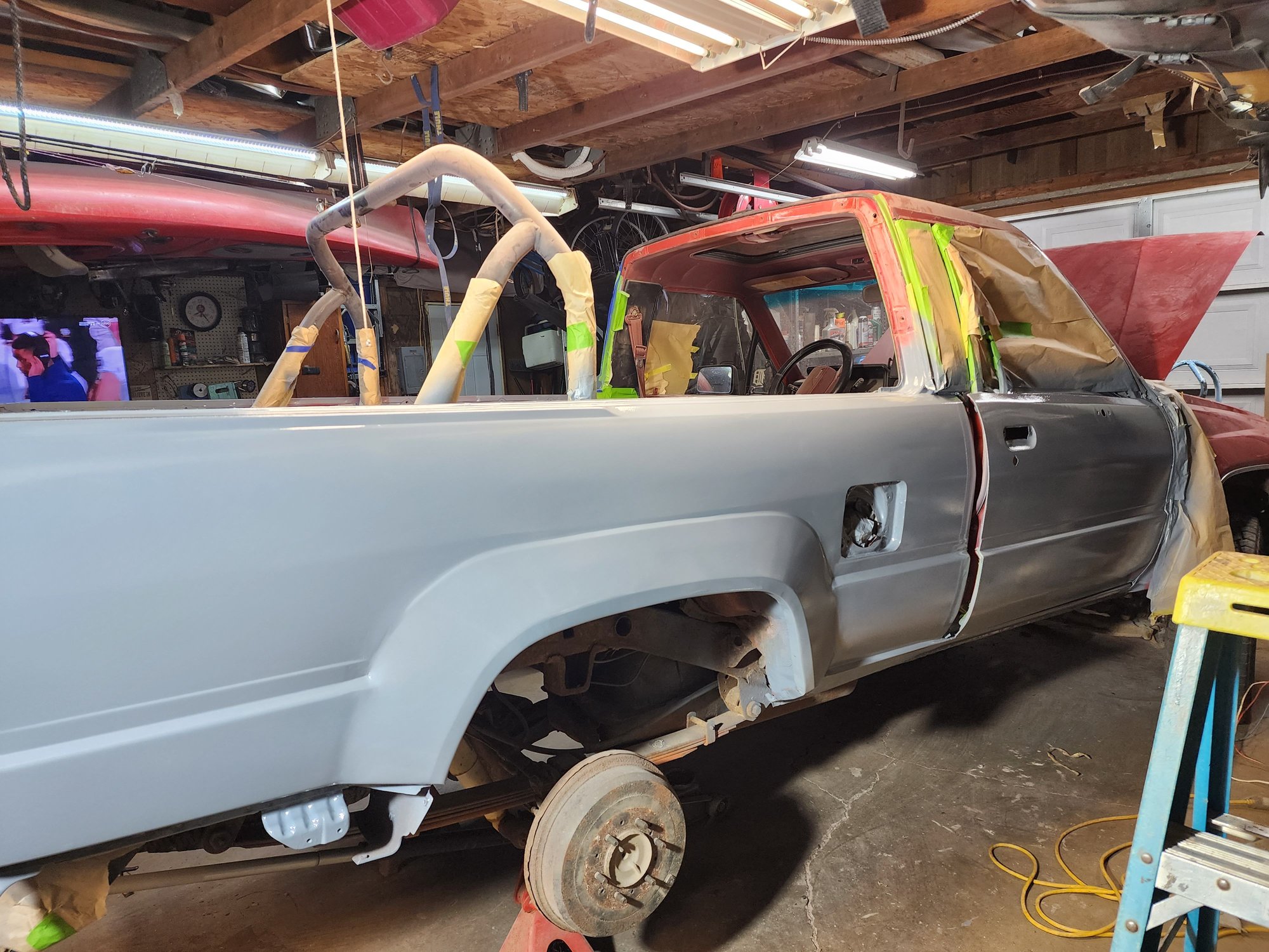

Once I slowed down my gun speed, the epoxy primer even had a shine. I've never welded (brazed before) or used a spray gun myself before this project, so I shouldn't be hard on myself if not perfect. Tailgate is the only welding and rust repair left that I'm aware of at this point, but it has a leaky windshield that has to come out. I'll probably rework the wheel wells at some point. That was where I started trying to figure out how to weld and looks terrible.

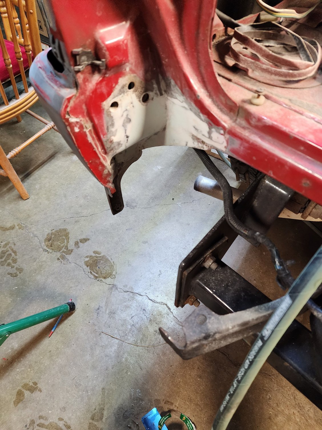

I sure opened up a mess here. Michigan salted roads suck.

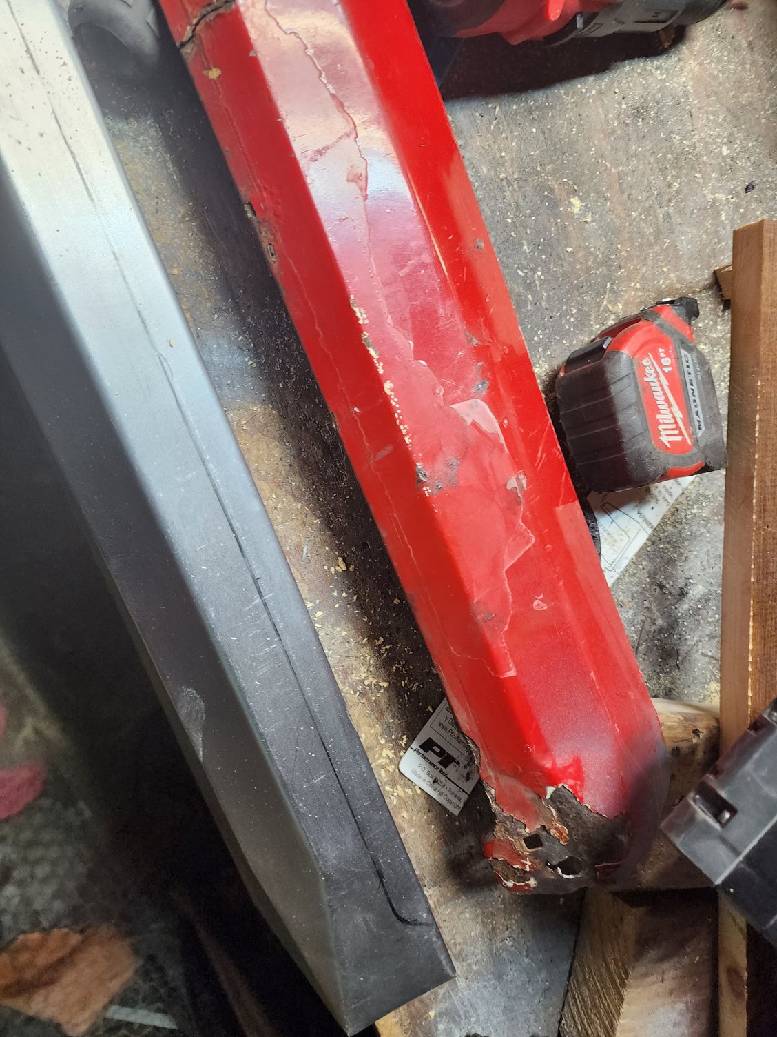

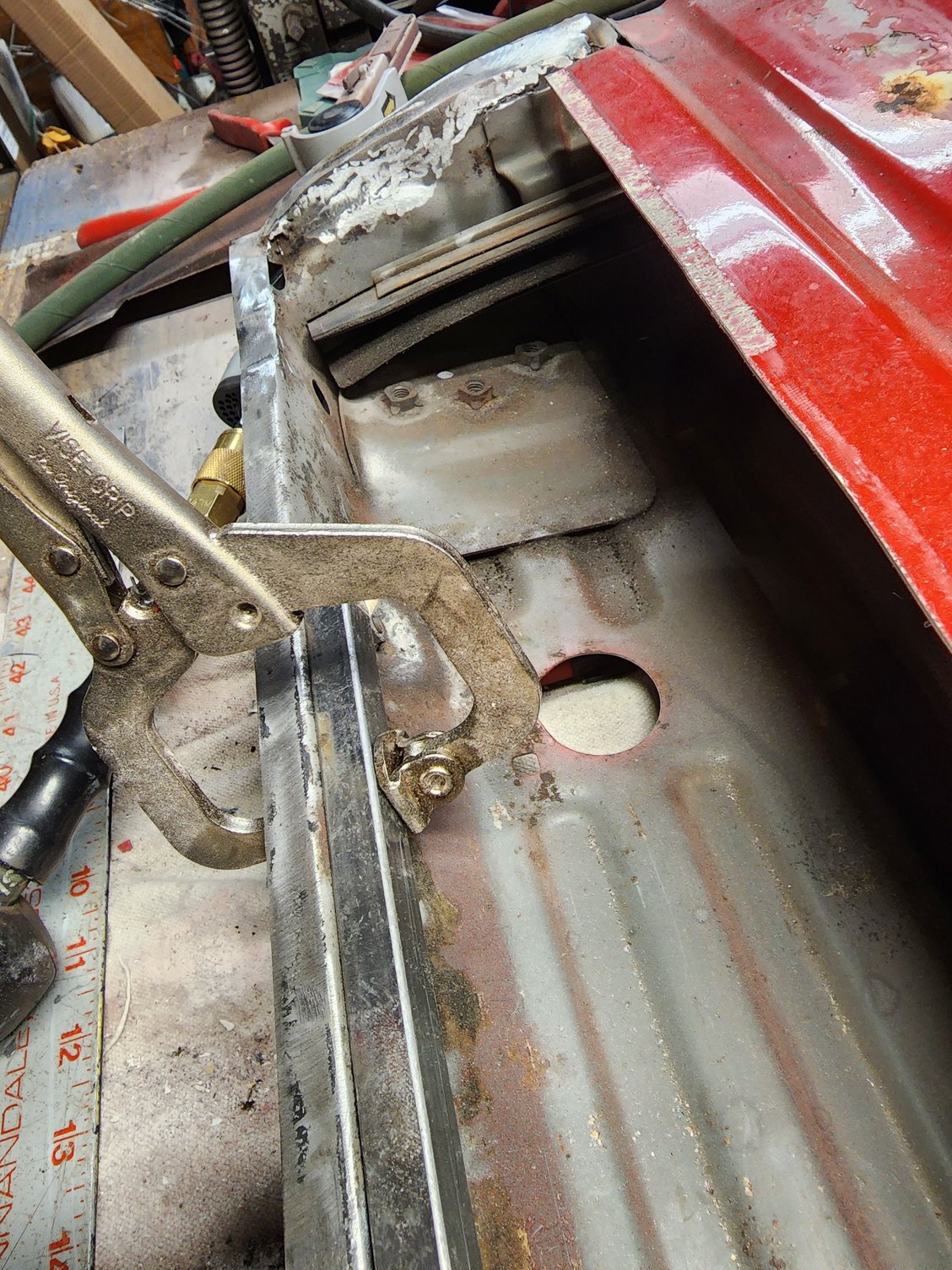

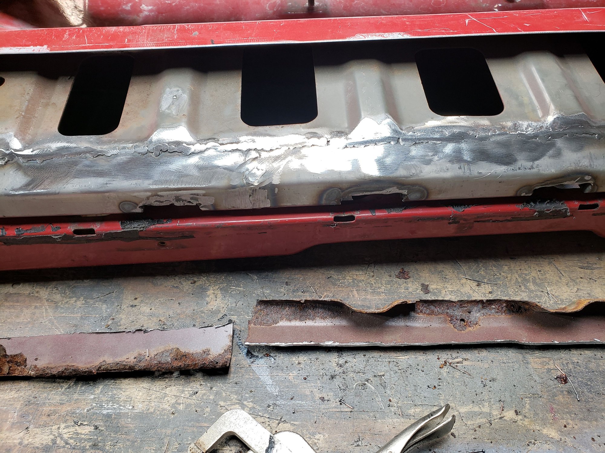

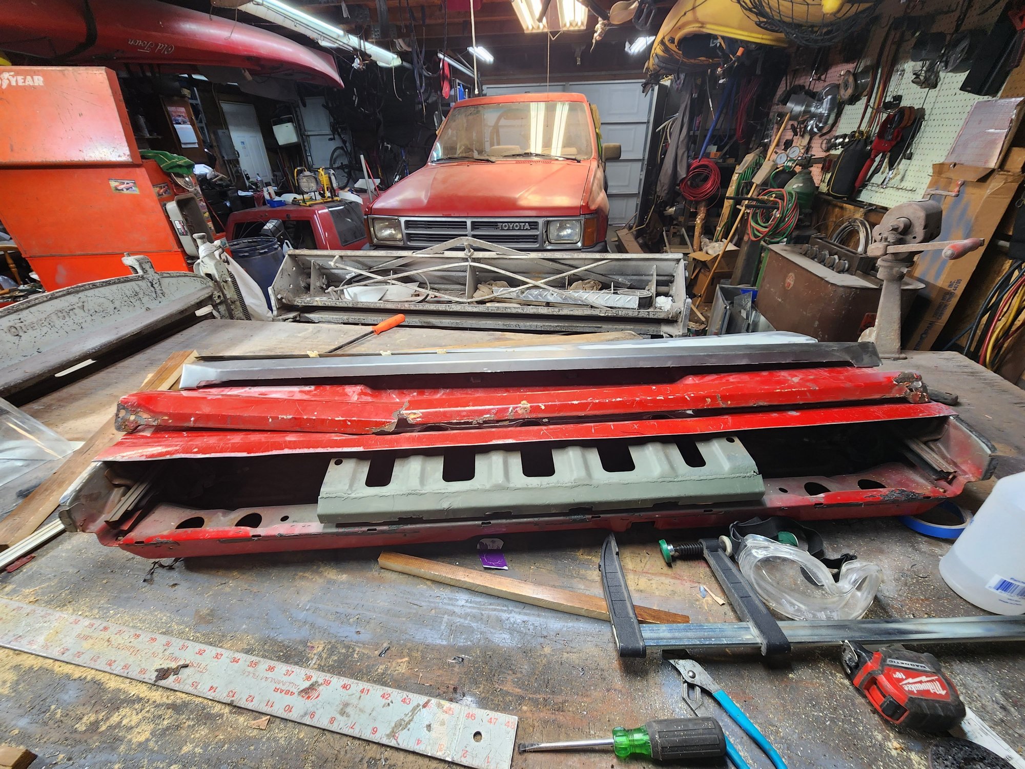

I patched the corners, and a small piece on the bottom. When I tried to fit the new panel, it was apparent that the inner panel was bowed downward towards the center. I'm going to try to correct it with some 1/2" square stock. I friend suggested panel adhesive and a flange tool to attach the skin. I was all ready to go that route, but this bowing and the stress a tailgate takes has me thinking I should flange and weld the top seam and panel adhesive with a few spot welds for the sides and bottom?

I know it's not pretty, but it'll never be seen and will hold the new skin.

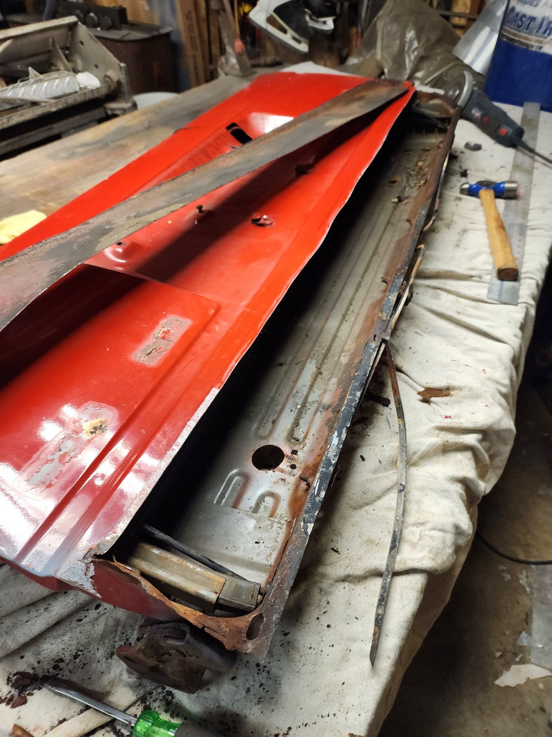

Now I find out the replacement piece is 3/4" too long. My brother has a finger brake, so I think I can re-work the piece there. Frustrating, one thing after another.

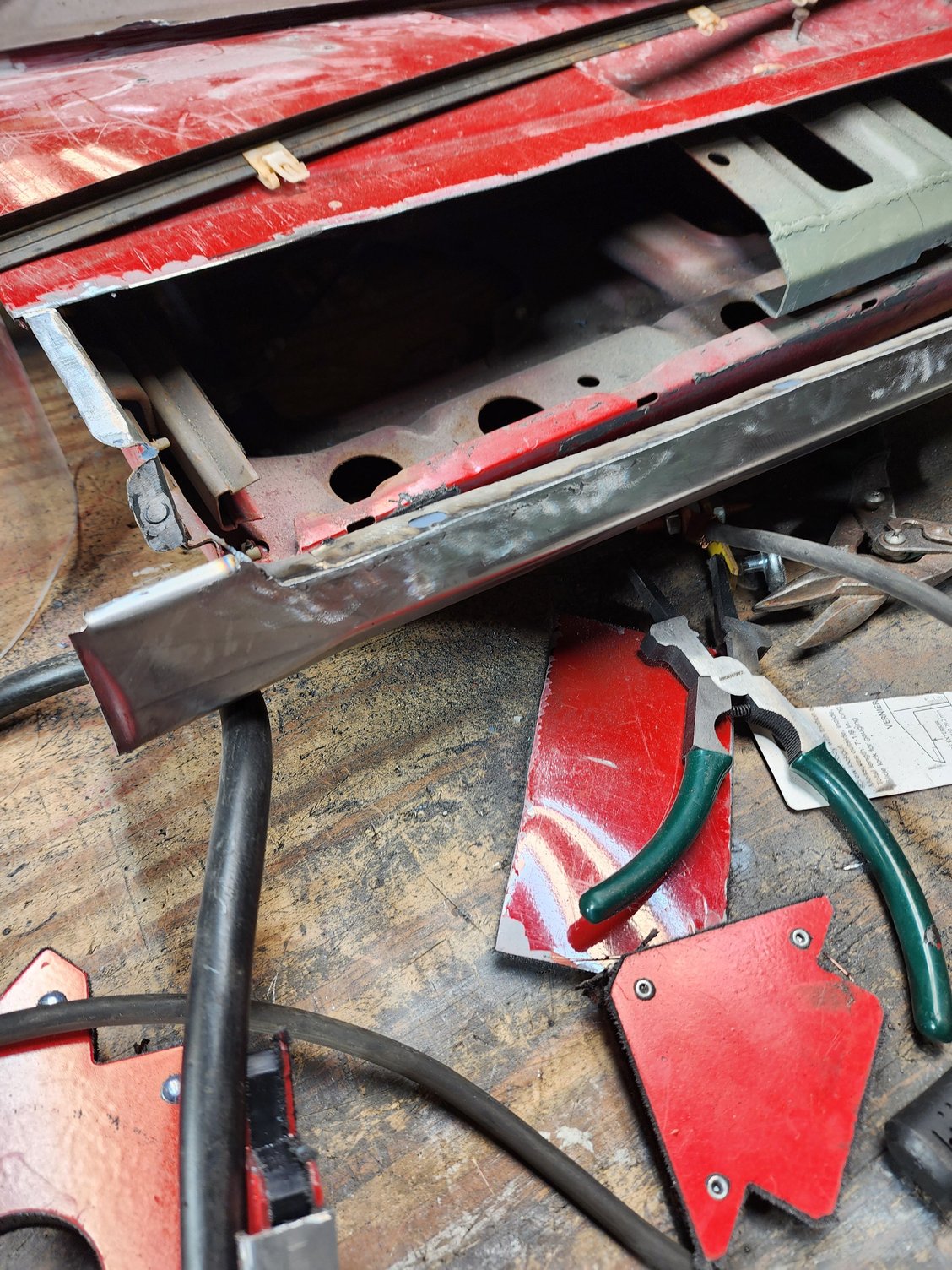

I was getting ready to install the piece, and noticed there was no cutout for the window to operate. Now I have to cut it out where marked, then weld a flange to reinforce it and to hold the weatherstrip.

I was going to give up and order a fiberglass piece from toyotafiberglass for $200, but the shipping was going to be $400 plus $200 for the part. If i knew starting out what I know now, i probably would have done the whole thing in fiberglass. There still would have been lots of welding to repair the inner panels to fit the fiberglass.

Thanks for the encouragement. Now that I have it cut out, I think it's going to work. This tailgate sure is time consuming. I knew it would take awhile, but the time is adding up on the tailgate. On the bright side, the only rust repair after this is under the windshield and sunroof.

It looks like I'm going to be able to make it work. I got the piece cut out out so the window can open and welded a flange for reinforcement and for the outer weatherstrip to attach. This tailgate sure is time consuming.

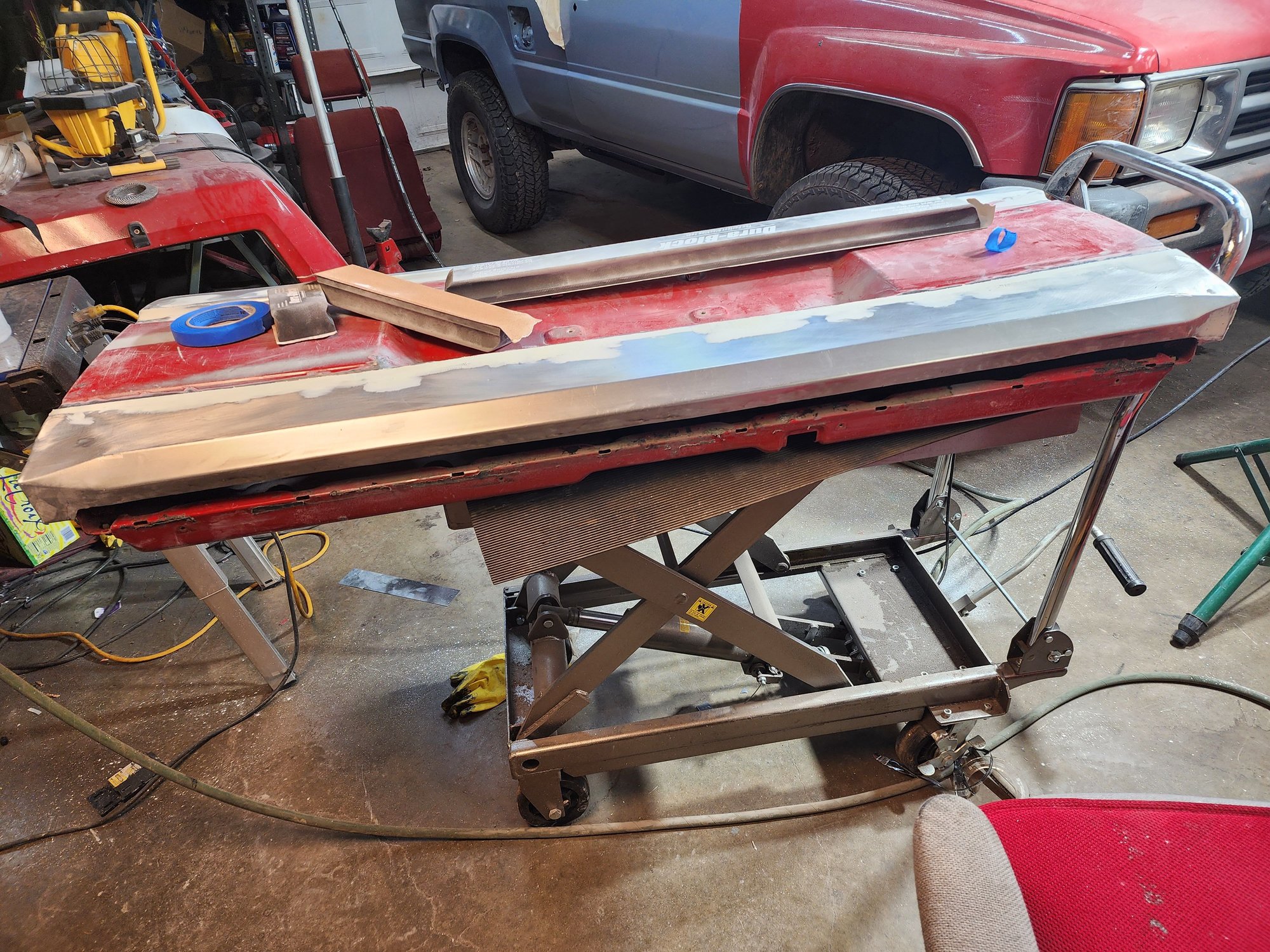

Work got in the way of the 4runner project, but getting really close on the tailgate. I broke down and bought a 30" Durablock sanding block, and that is helpful on the tailgate, and will be when I smooth the panels out some more.
