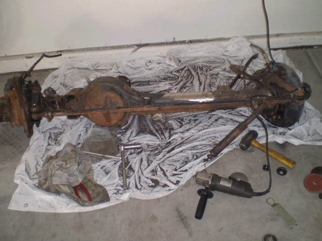

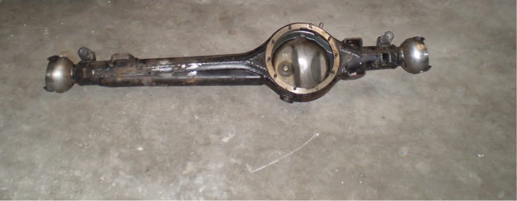

i have the 84 axle with the long truss i got it at pick apart for $300.00. i ordered the 4 inch lift springs. i stripped down the axle and cleaned up all the parts. i started work on cutting the brakets that i wont need off

Nice I got my 85 4 runner axle for $200 with the springs.
However urs looks a little less rusty.
Nice job though.
