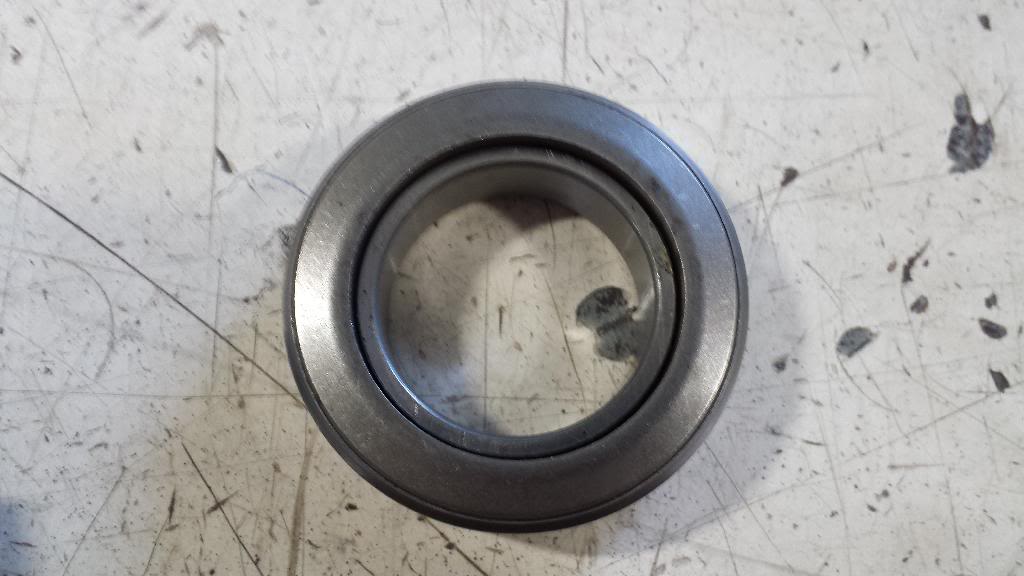

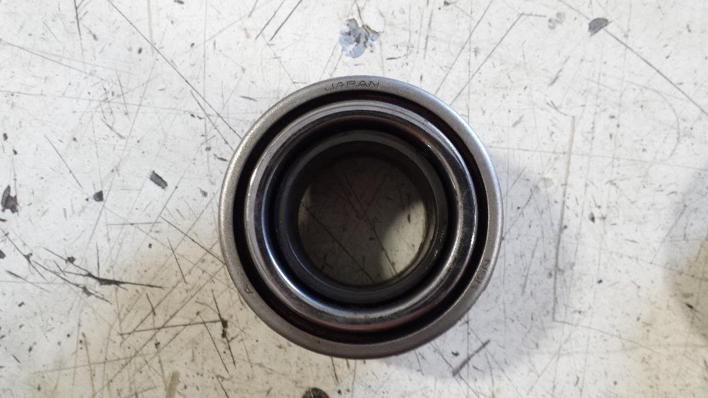

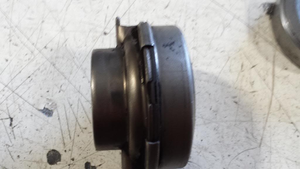

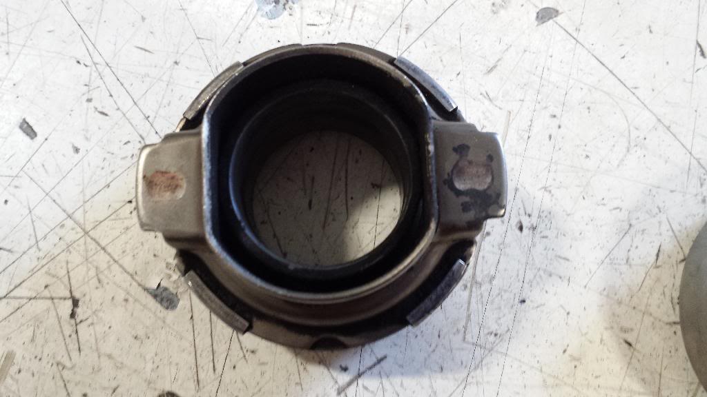

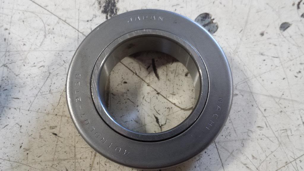

Ive ran into a problem, the release bearing (next to the fork) is different than the one I got in my marlin crawler kit... the bearing I took out has four metal "clips" that are bent over the housing, I dont know how to change them out because its different than I have seen, any ideas?

The first 3 are of the old bearing and the housing, and the last two are of the new bearing, do I need a different and new housing?

That's odd i never knew you could disassemble a throw out bearing. When I got my clutch kit it came with one like in your 1st pics.
Have you called marlin about it?

Marlin is closed haha, but apparently there are two different types of throw out bearings, one complete one like my first pictures and one thats a hub and the bearing and two clips... so confusing, where did you get your thowout from?
