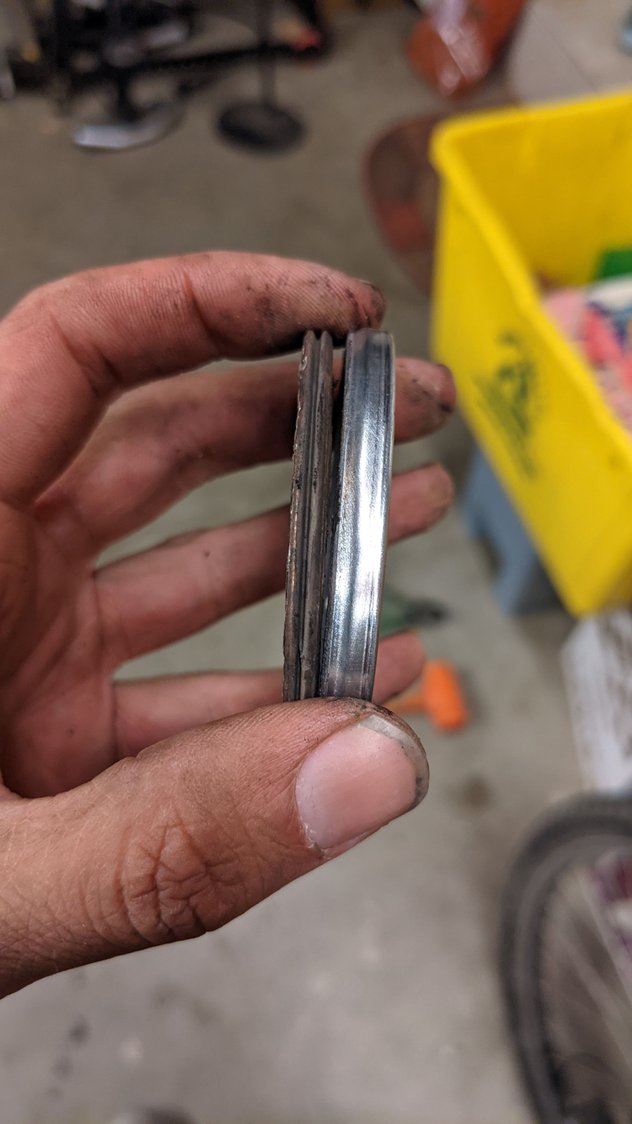

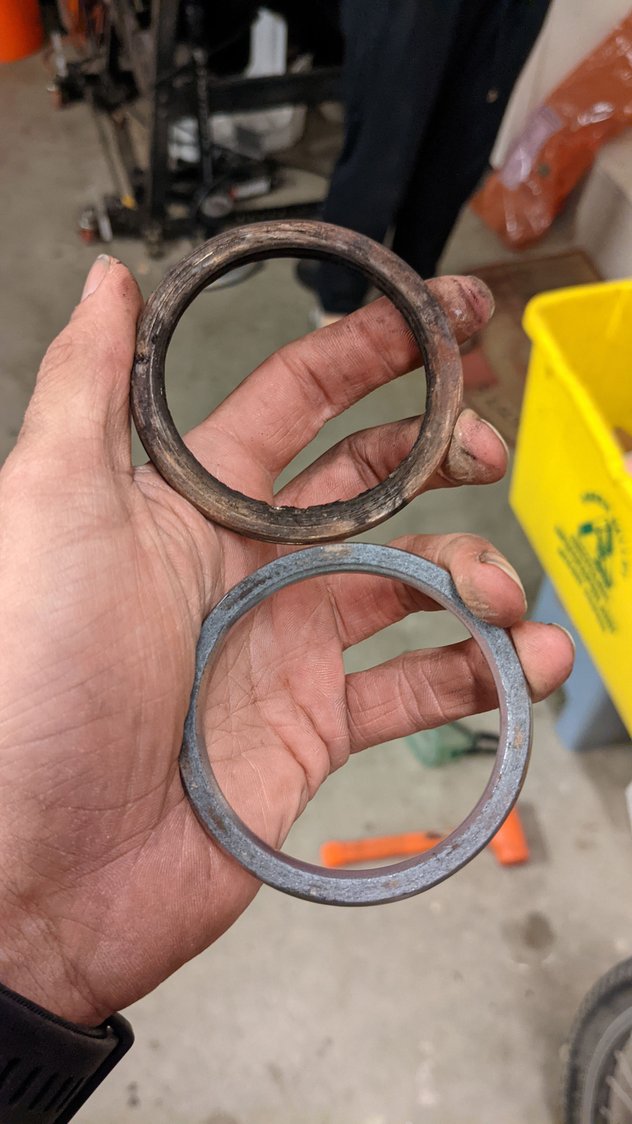

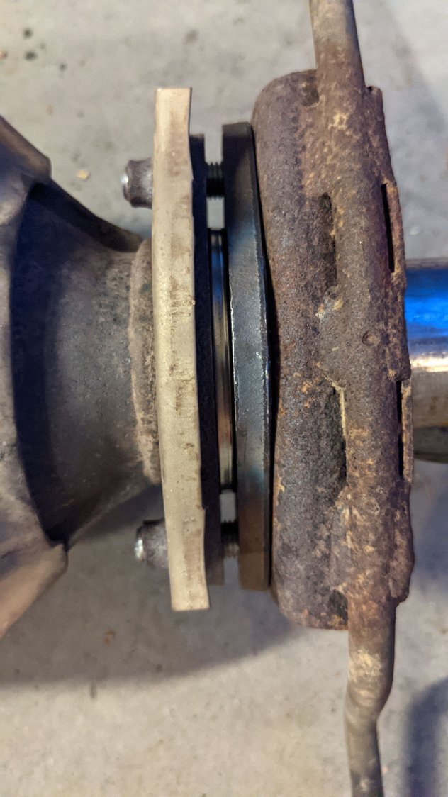

The first, and biggest, snag is that I believe I bought the wrong gaskets to put between the catalytic and the muffler. On RockAuto, it told me to buy Walker 31374 since it is a Walker brand muffler replacement, but as you'll see in the photos below, this gasket is much thicker than the one that came off. Also, it appears to be half solid aluminum on one side and some sort of fabric-y gasket material on the other. When installed, there is a pretty significant "sandwich" between the cat and the muffler due to this larger gasket. Is this the correct gasket? Or do I need a different one? If so, which one? Would I need the same one to reconnect the cat to the header?
Top is the original gasket, bottom is the Walker one
Side by side - one is significantly thicker
Installed between cat and muffler

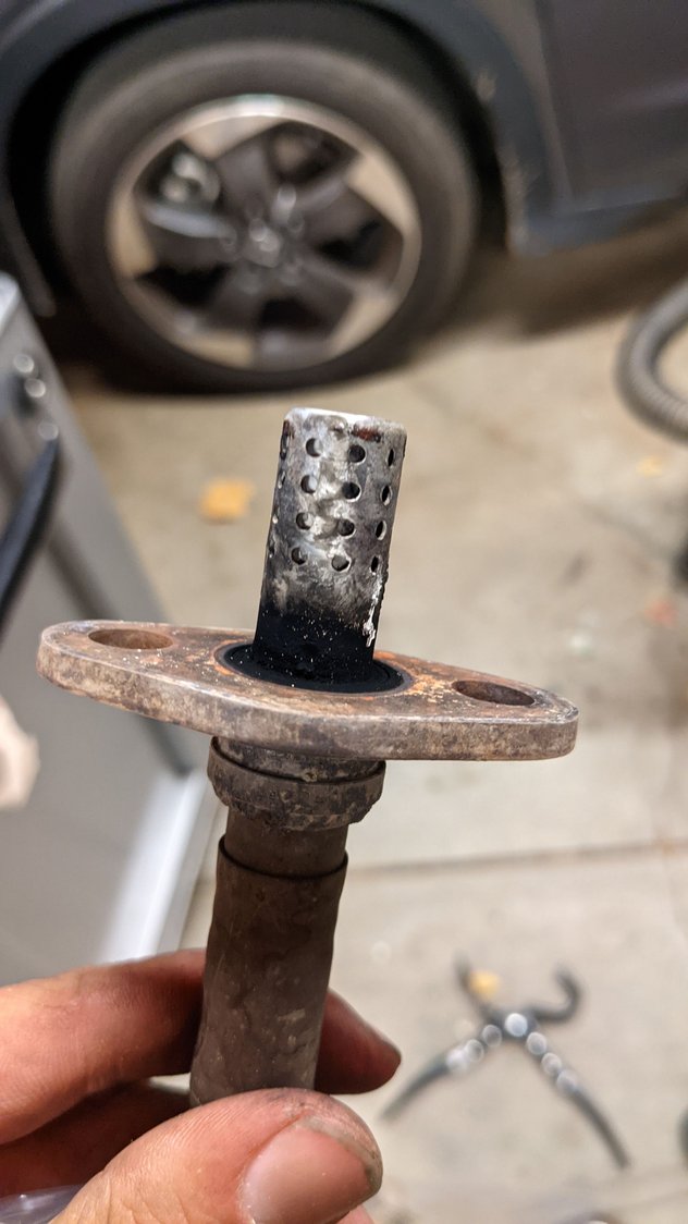

Problem #3 - Is there any visual way to check if the o2 sensor needs to be replaced? It definitely looks sooty - pic below - but I'm not getting a CEL or anything.

Those exhaust pipe gaskets are thick off the shelf, and compress substantially during installation. This also makes them hard to re-use and get a successful seal. Pretty much a one shot deal.
I just used the Toyota gaskets. Seem to work fine

Quick rule of the thumb. If the CEL is off everything is working. Not an ironclad guarantee, but lets me sleep at night.

Anywho, on the O2 sensor, if you have ANY doubt about it, replace it. I've put two into my 87 so far simply due to mileage. I think that the FSM I got with the 4Runner specified 60K miles for the O2 sensor replacement. Even if it doesn't, and I can't find where I saw it now, of course, it seems like a decent interval for the sensor replacement. It sure made a big difference in the engine's power, and mileage when I replaced the sensor. Much improved.
Remember to clear the ECU's memory when you change the sensor. It makes it's learning curve shorter. It takes at lease 2 trips for it to start it's learning. 20 miles, I believe. Easy to do. Pull the EFI fuse in the cabin fuse block, IIRC. Might be engine compartment fuse block. I, personally, just pull the negative battery lead for a minute or so, when I do it. Well, changing any electrical part, the negative leads come off the battery until it's totally completed. Just a lot easier for me to do, and to remember where it is You really should pull the negative battery lead when you do go to do replacement of the sensor, anyway.
Finally, then I'll shut up, I ALWAYS put a dab of silicon dielectric grease in any female lead I pull, and plug again. It really helps keep dirt and corrosion to a minimum. That includes plug wires, heck, everything. I love that stuff.
If I were you, I would absolutely replace the O2 sensor. Do NOT go with after market sensors, BTW. Especially Bosch. Those may SAY they're compatible, but they're made for European engines, not Japanese ones, and don't seem to provide the exactly correct outputs to the ECM. Close, but not exactly correct. Get a Japanese made sensor. Aisin, Denso, whatever you can find.

Yes, I would. But if you are going to just replace one, the upstream one is the one to go for. It has the greatest effect on the mixture settings the ECU uses.
