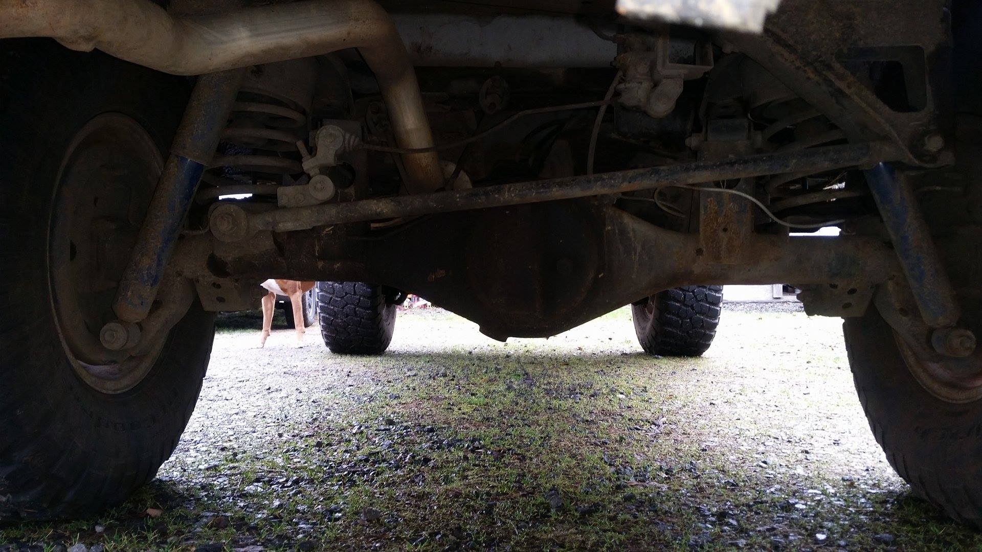

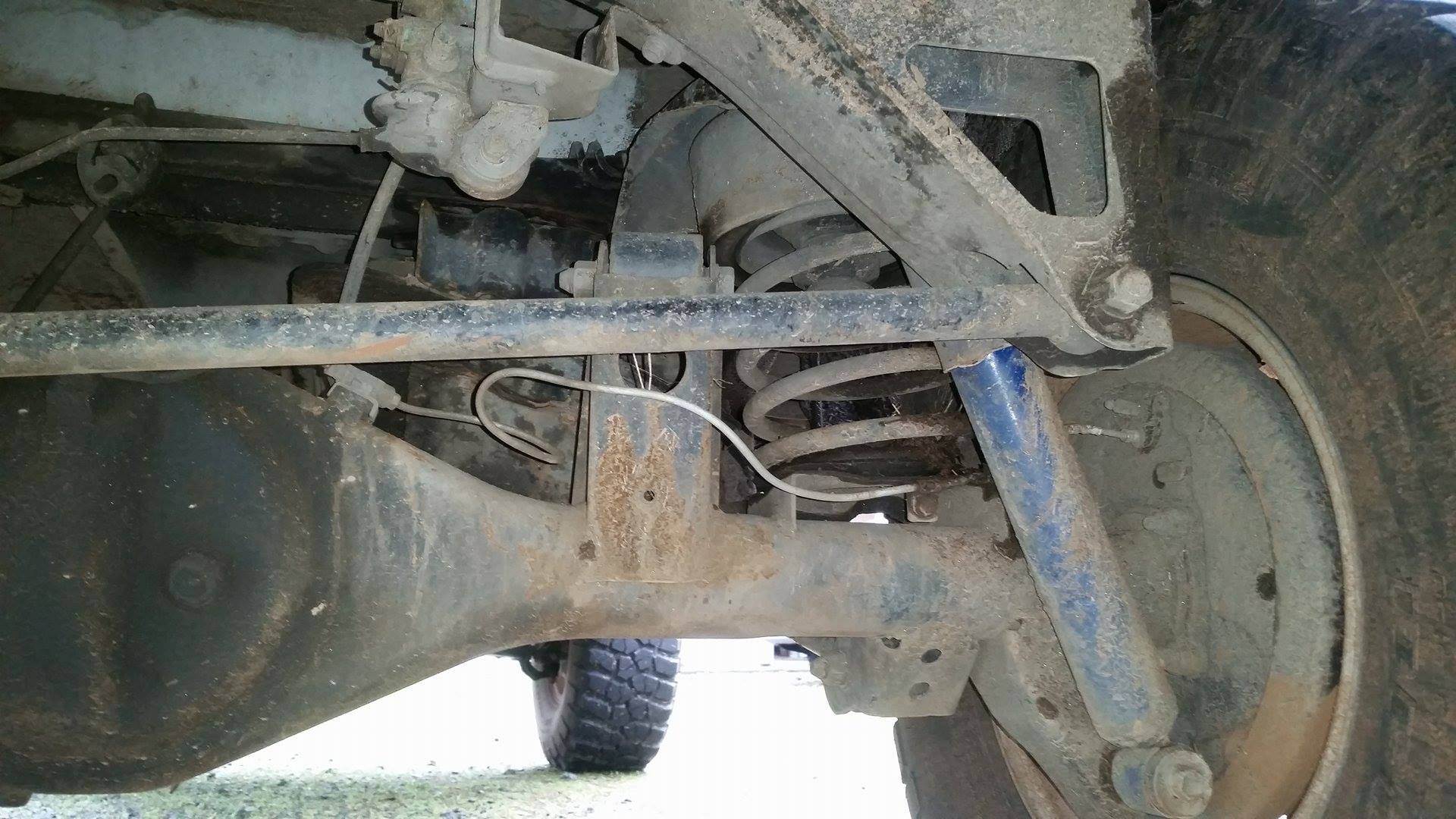

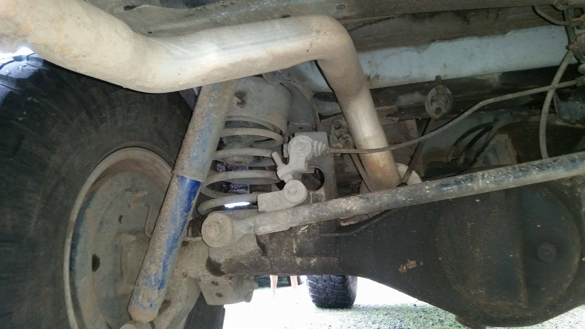

Second issue is the rear suspension is very unpredictable, especially under power. I noticed my panhard bar is not parallel with the ground or axle. The guy who sold me the rig claimed suspension was stock all the way around except for cranked tbars up front. Could this be the culprit of the handling woes? it shifts left to right in a kind of roll and sit motion when power is laid down with any sort of urgency. Being stock geometry i was really surprised to see the panhard not parallel which is what 4crawler's write up said your after to maintain stock handling...color me confused.

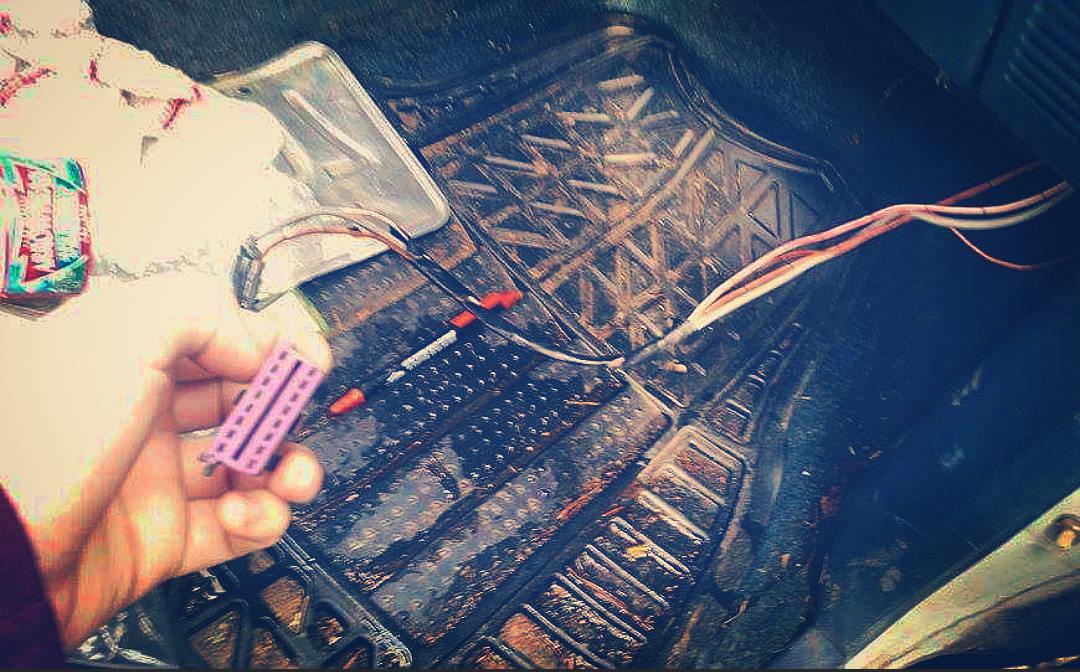

Another random ghetto issue. I was buttoning up various plastic bits inside that obviously had been very halfaz'd back together with missing fasteners ect and this little fella dropped out from behind the glove box. Look familiar to anyone? not ringing any bells here, im thinking maybe its a shoddy CB radio wire job? its all hangy and wires are loose.

Still have no clue why the back suspension geometry looks off when its supposed to be a stock setup. This is how it sits right now

Which reminds me, nobody has commented on the angle of my panhard bar ..dangit, i need closure. Ordering a 4set of bilstein 4600s unless someone talks me into the 50$ more a shock for OME
