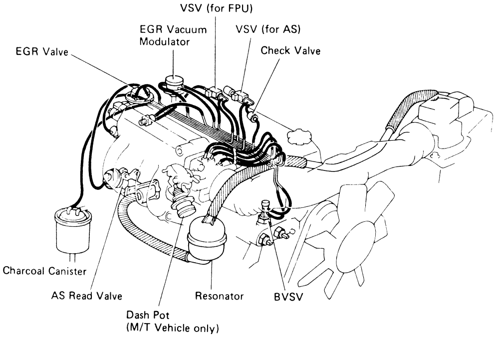

This is how Tuesday's motor is configured
This pic is the only one I have seen that looks exactly like mine, I am missing the Dashpot(need new one). What is missing here that I have is the 2 vacuum lines from power steering side that go to the EFI intake

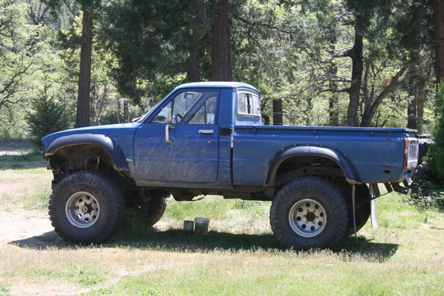

Snobdds
Here she is....tada
https://www.yotatech.com/members/mud...k-progress.jpg
Had to post the link used up attachments on the wiring task it was a big one.
Still trying to figure out how to clear them out....
BTW I don't have a smog pump, the pic of the engine on this thread is what my engine looks like only dirtier, I think there is a pic of the engine in my album.
