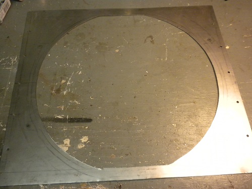

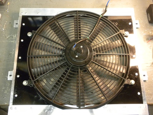

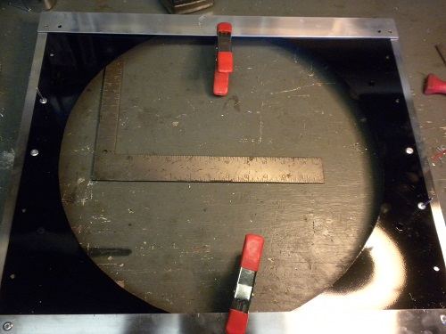

Enough of that... So below is the new fan shroud I built for the 3.0. It's 1/16" thick- 1-1/2 wide aluminum angle for the frame with a 1/32" thick piece of sheet metal as the face. All riveted together with 3/16" aluminum pop rivets. The fan I'm running is a slimline 16" fan from Zirgo (IIRC) set up in a "puller" configuration.

Hey thanks! Deleting the fan clutch typically adds 3-5hp as a rule of thumb. But to answer your question, yes the change from fan clutch to electric was noticeable with the 3vze. And yes, I run an adjustable temp thermostat probe type fan controller. If you look carefully in the 3rd picture towards the 2 o'clock position you can see a small grommet in the black sheet metal... that's where the probe slides through and then into the radiator.
