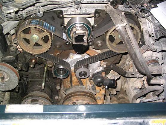

Hey Gang. I recently replaced the water pump,timing belt and both idler pulleys on my 95 4runner 3.0 . When I went to put on the fan bracket, it was hitting the #1 idler pulley. I took off the new idler and put on the old one...same result. When I take the idler pulley off completely, then the fan bracket goes on smooth. When I put on the new timing belt on ,everything lined up and the pulleys lined up after 2 rotations. I already tried looking through alot of the threads, no luck , just frustration. If anyone has any ideas or pictures on how it should fit on or look .........PLEASE help. thanks

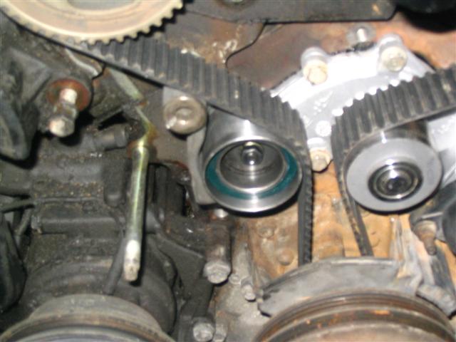

I tried to post a couple of pics but it said my file was to big. I'll try to make them smaller and post them again.
Attached Thumbnails Fan Bracket Won"t Fit on 3.0-img_6751-small-.jpg   Fan Bracket Won"t Fit on 3.0-img_6748-small-.jpg
Old Dec 31, 2008 | 03:56 PM
tyndalltoy's Avatar
Joined: Feb 2007
Posts: 43
From: tyndall,mb,canada
Good ...it worked. Hopefully these will show enough. Happy New Year !!!!!!!!!

You need to install the fan bracket first, THEN bolt the hydraulic tensioner into the fan bracket. It will then pull the timing belt tight.
Old Dec 31, 2008 | 05:02 PM
tyndalltoy's Avatar
Joined: Feb 2007
Posts: 43
I can't get the fan bracket over the idler pulley. I took the tensioner off before I tried putting the fan bracket back on.
Old Dec 31, 2008 | 05:33 PM
DeathCougar's Avatar
iTrader: (23)
Joined: Jan 2003
Posts: 17,692
Likes: 58
From: Marysville, WA
Well i guess I am not seeing it then. you have everything installed correctly. Sometimes you need to pull up a little bit on that tensioner pulley, since there is enough slack to let it hang down and contact the bracket.
Old Dec 31, 2008 | 08:08 PM
tyndalltoy's Avatar
Joined: Feb 2007
Posts: 43
I'll give it a shot. We'll see if it will be a good start to a new year!!
Old Jan 1, 2009 | 03:36 PM
Cyberman's Avatar
Joined: Nov 2007
Posts: 954
From: Dillsburg, PA
Ya, that idler should move to the right a little, tighten the belt, and the bracket should fit over. The idler is moving, right?
Old Jan 1, 2009 | 04:02 PM
tyndalltoy's Avatar
Joined: Feb 2007
Posts: 43
I finally got it set up. There is a bolt hole just behind and off center from where the idler bolt should have been. Well...... as the famous saying goes "Learn from your mistakes". Thanks for all your help. CHEERS!!!!
