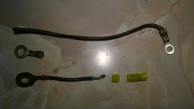

You didn't state what condition that wire was in (spliced) but yet I feel as I have failed you. Why is that you ask?
Well this is what I encountered when I first purchased my truck. I didn't have any problems with it but it was just a matter of time.
The lower one is the same one you had a problem with. I was suspect of it when I purchased my truck so I put it on my to do list.
Anytime I see a butt connector that doesn't have adhesive lined shrink tube on it I'm redoing the splice!
I also noticed alot of those same wires looked pretty bad when I was hunting at the salvage yards. I might have to add this to my guide.
The top one was the ground strap that goes from the back of the head to the firewall.
