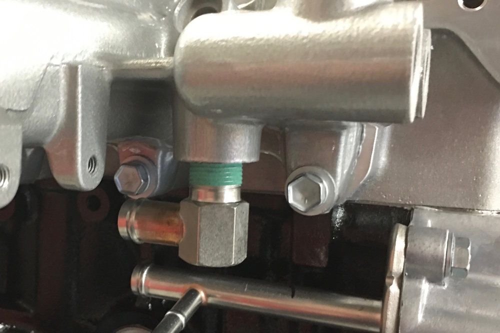

Originally Posted by sammycpt
Intake manifold coolant union. Coolant bypass hose that is U-shaped connects to the union, and to the hard pipe that is connected to the back side of the timing cover/passenger side.
https://22reperformance.com/22re-coo...-coolant-union
