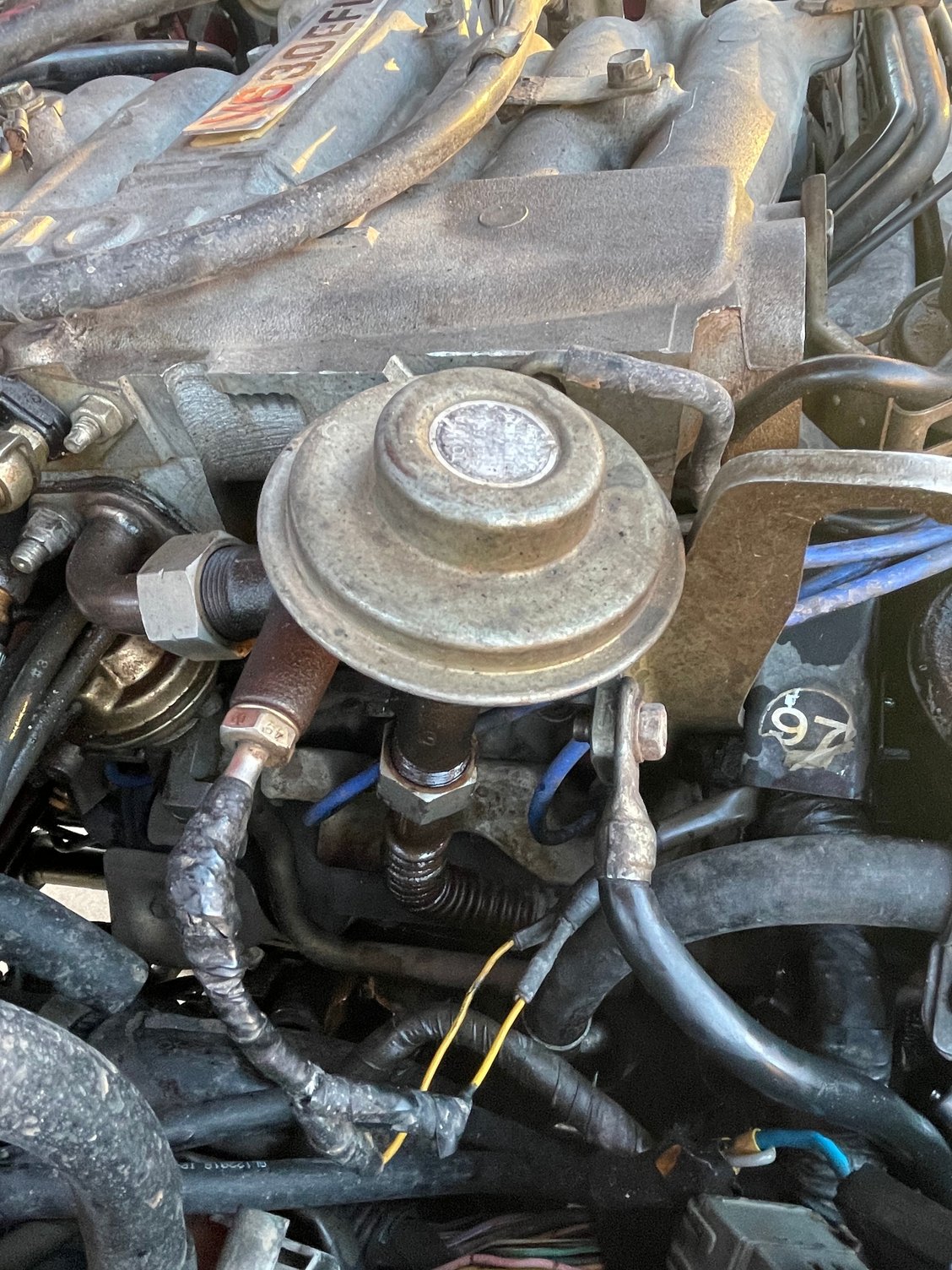

My 95 3vze EGR valve seems to be seeping oil. Anyone have an explanation for this?

Have you checked your plugs for oil fowling? Maybe your valve seal(s) or your piston rings are allowing oil to bypass and get into the EGR system. Also check you PCV valve. I'm not sure if this could cause the oil blow by but it's an easy fix regardless.
