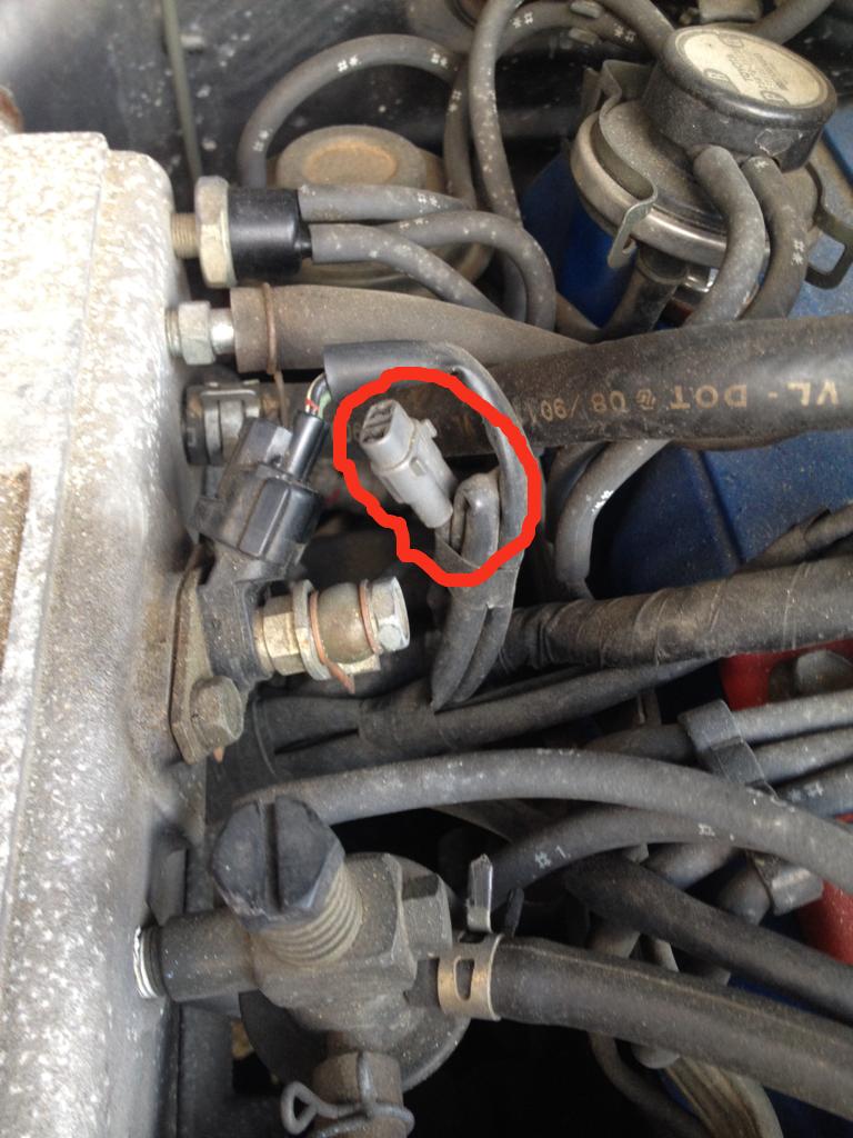

Thanks for your help. I've been busy so this is the first day I've had to think about this. I started looking at the wires and noticed that there is a wire connected to the cold start injector, but then another wire taped up out of the way, as if it used to be THE wire:
Is it possible that this wire had a purpose, say in a california rig? If the wire connector was replaced at some point, I can't figure why the previous owner wouldn't have just removed this old one.
This has me thinking how to check whether my cold start injector ever shuts off. Could that explain the poor gas mileage? If it didn't shut off (ie, the cold start timer or the coolant gauge says it should keep putting in gas) wouldn't their be a check engine light?

I'm not real familiar with the 22re, so I can't help you with the unused connector (and, I don't recognize it, for what that's worth).
I doubt your CSI is stuck open, as I would expect that to flood the engine. The CSI Timer is easy to check; just unplug the connector from the CSI and see if it makes a difference.
BUT: you could have a leaky CSI; not enough to flood the engine, but enough to wreck the mileage. Since this would make you run rich (and you're got fuel trim saying you're fine) I doubt that's the case. But you can check that by removing the CSI, leaving it connected to fuel and signal. Start the fuel pump by jumpering. The CSI should not drip anything.

I just checked the ohms spec for the the cold start injector (3.3 ohm, which is between 2-4 according to the '93 manual) and the ohms for the cold start timer (80 ohms, which is appropriate for both temperature and is within range).
Is this the test where you put the cold start injector into a jar and add 12 volts to see it work? If not, I'm not sure what you mean by the quoted statement above. If it is that test, are you saying that if the CSI isn't working, then it should "not drip anything".
And, yeah, I sure wish I knew what that extra connector was about.
