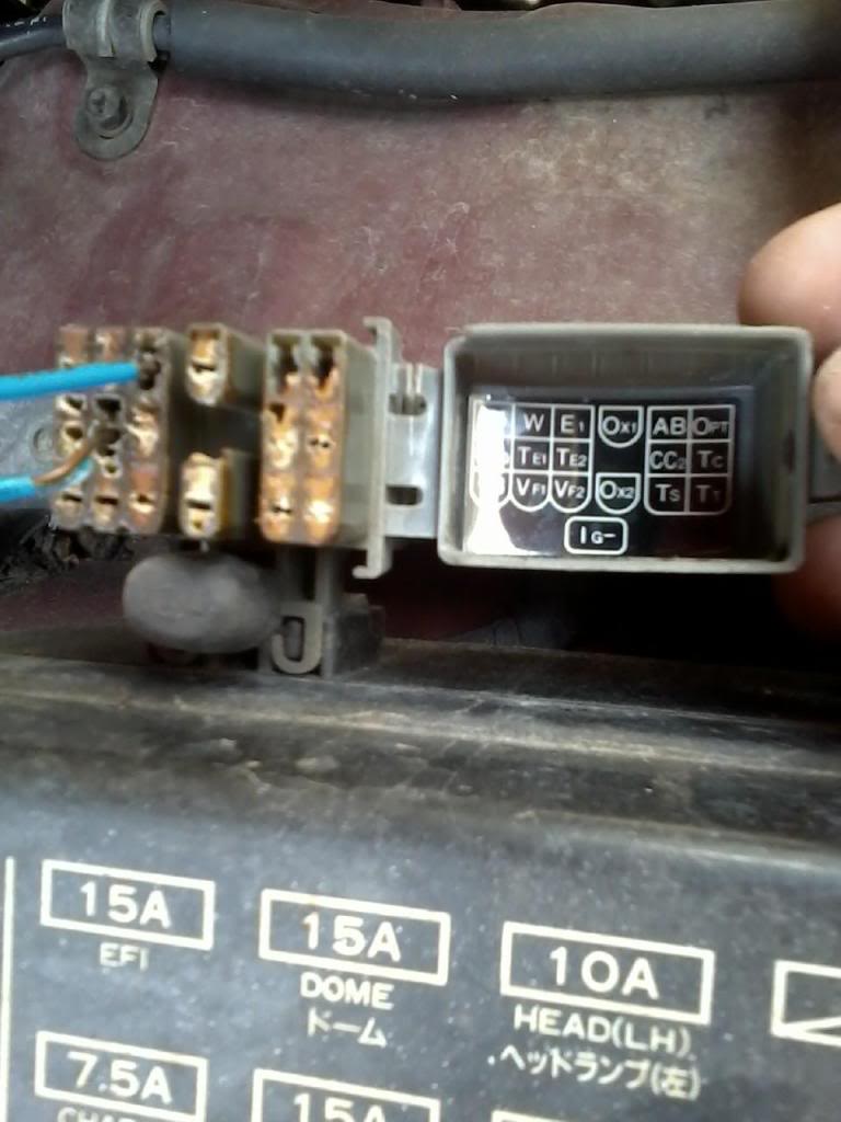

My check engine light has been on since I bought my 1990 toyota pickup over a year ago. I take it to the dealer and they say its a code 52(knock sensor) and want $1500+ to fix it. So I'm like screw that! idt so lol. I then take it to a mech down the street and i tell em what i think is wrong. They fix the knock sensor, buut.. the check engine light is still on, over 900 bucks later and nothing is fixed but they did tell if I asked them to do a diagnostic they would have found out that its the ecm/ecu. Im like well thanks for trying to help me out a-hole. anyways my question is what do i need to do? can i get it my self and do it.. should i just take it in and get it done?

Attachment 95831

The ECU is behind the passenger kickpanel under the dash. Once you get the cover off, it is just 3 bolts that hold it on and 3 plugs. You didnt say if it was 22re or 3.0 but doesnt matter as far as what you are experincing with exception of ECU. Part number is on the ECU.
I have never had a bad ECU and is the very last part I would suspect failing. There is always a chance of one being bad. They are rugged but not water proof. Only ones I have seen bad were flooded. I would use a junkyard one myself.
Not criticizing you, but with what I see about sending it to shops for this issue and cost, I feel you have very little experience on these. My bet is it is the wire to the Knock Sensor. Dont think I have ever changed Knock Senors come to think of it, they are rugged. Get a Haynes Manual, it is what I use most. I have the Factory Service Manual and you can find one on ebay occasionally. Got mine for $30, and I use it very little. Only for in depth trouble shooting and even the FSM says it is for the advanced users.
Only having the truck for a year, I would do a complete tuneup using quality factory parts. Parts store quality is not the best lately. You can get factory parts off of ebay for alot less then the dealer.
Use a paper clip for the picture below and see if there are any other codes. TE1 to E1. Look at other areas that can cause a knock senosr to get activated. Bad timing, poor fuel, carbon build up.... How are your vacuum lines? Replace and route correctly with good ones. Clean the carbon out of the Plenum and on the ports and hoses. Do the Seafoam treatment. Clean the other sensors while at it.
Also check the connector to the ECU and see it is just needing reseated. I really dont think you have an ECU problem, but if the dealer says you do, they will have better means of checking.
I clear the codes by removing the battery cable for about 10 minutes and see if it comes back. On a 22re, this is fairly easy to do and if you have some mechanical experience is nothing to be worried about. Other then tune up parts, is not very expensive to do. I would only remove the Plenum if you decide to do this yourself. The following 2 pages will show what you are getting into.>>> https://www.yotatech.com/forums/f199...l#post52146627
Codes... http://4crawler.com/4x4/CheapTricks/...es/index.shtml

Originally Posted by Terrys87
.... Look at other areas that can cause a knock senosr to get activated. Bad timing, poor fuel, carbon build up.... How are your vacuum lines? ...
While setting the timing, using the right octane, and having good vacuum lines are all important, it's worth noting here that they have nothing to do with code 52. Code 52 does NOT mean the engine is knocking.
Instead, the ECU is constantly advancing the timing until the knock sensor reports knocking, then the ECU backs it off a hair. Resulting in optimally advanced timing at all times. Even if you were using 60 Octane gasoline! (If you could get it.) But if the knock sensor stops reporting (here, probably due to a wiring issue), the ECU could keep advancing the timing until the un-reported knocking blows a hole in a piston. So to protect the engine, if the ECU stops hearing from the knock sensor, it retards the timing and throws code 52.
Having a clean plenum is a good thing (and once it's off to replace the pigtail, you should take the opportunity to clean it anyway), but it won't help Mauk's problem.
