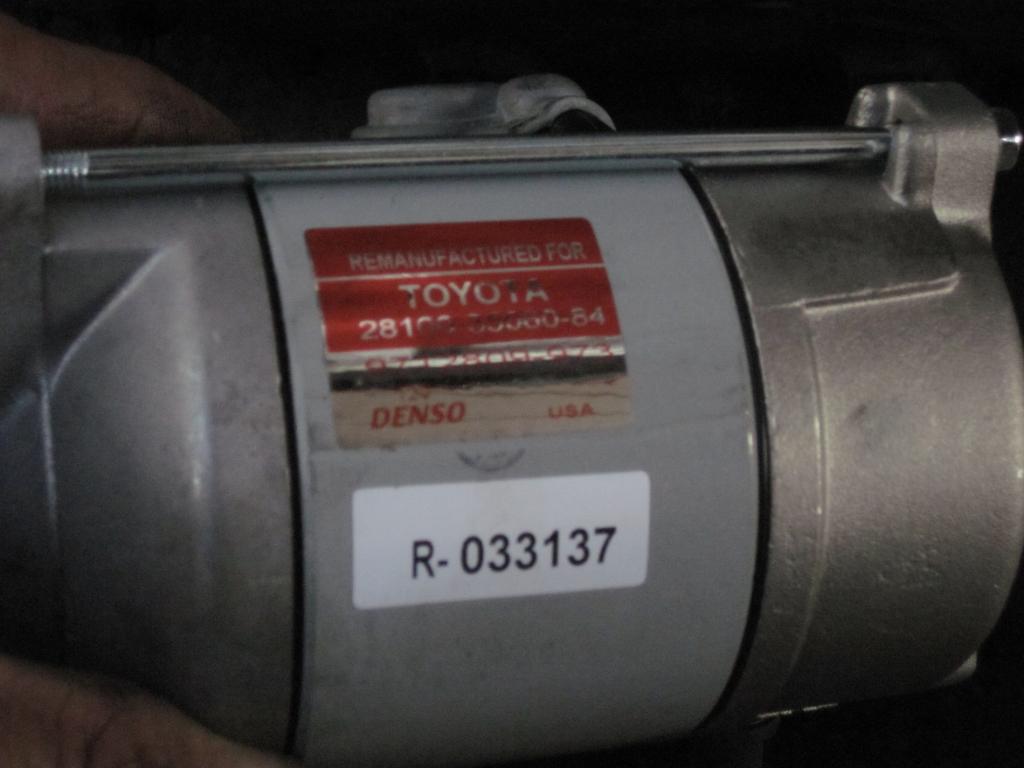

I bought OEM Reman for Reliability and No Hassle
I bought remanufactured for Toyota OEM because I wasn't sure what starter was on my truck (definitely not Toyota stock) so to take it out shop for the correct contacts then replace it would have been too much work (take out, disassemble, find out what contacts it needs, reassemble, re-install), trouble and downtime, not to mention the fact that because it was not stock, it would not be honored as "core" for OEM part.
Definitely worth the higher price, considering:
1) Reliability,
2) Higher cranking power (1.4kW, vs original 1kW),
3) I know exactly what contacts it would need when time comes,
4) It is OEM core so will be honored if I have to replace the whole starter later.
