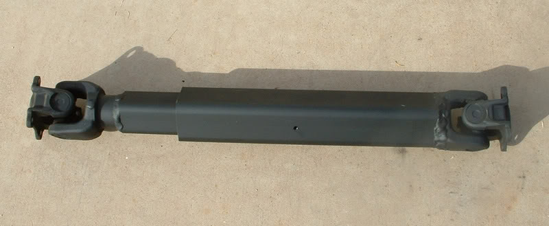

Joined: Jun 2005
Posts: 3,415
Likes: 10
From: Phx, AZ
Originally Posted by Junkers88
This mod keeps getting more and more expensive.
They all do.
You can save some pennies building a square front DS. I had one, worked okay but pretty ghetto. Very strong though.
On that note how do I measure for drive line changes? Can I just add the 6 1/2 inches to the front shaft and subtract that much from the rear?
You are on the right track, but honestly it would be best to have the dual assembly at least built if not actually installed before you start measuring for new driveshafts.
By the way, have we established whether you have a V6 or a 4CYL... because that will change everything...

how did you build that front shaft???? and would it be ok to use it in the rear if its that strong? just asking cause i have 3 trasfercases out back and plaing on using all three and need some strong stuff
Sure it would work...as long as you dont go over about 15 mph.....
my main beef with square shafts (besides the god-awful racket and inability to balance) is the fact they when they hit a rock ...they dont slide over it like a round tube...they push the shaft over the rock or break it This put a butt load of stress on the t-case bearings and output shaft and seals creating leaks and/or other problems
Just search "square shaft" and you'll get a lot of info. It's basically two pieces of trailer hitch stock mated to Toyota ends.
Would it be ok to use it in the rear if its that strong? just asking cause i have 3 transfercases out back and plan on using all three and need some strong stuff
The square shaft is strong in regards to impacts. I suppose it would be stronger under torque load as well, but generally stock Toyota joints are used so a square shaft has similar weaknesses to a "stock" round shaft.
Originally Posted by dirtoyboy
Sure it would work...as long as you dont go over about 15 miles per hour.....
That is a very true statement. I never could get mine to be just right. Your speed is limited and noise is high. I have heard that some have better luck however. It's the cost (under $50) for a burly front DS with over 12" of slip that attracts most to the idea.
My main beef with square shafts (besides the god-awful racket and inability to balance) is the fact they when they hit a rock ...they dont slide over it like a round tube...they push the shaft over the rock or break it This put a butt load of stress on the t-case bearings and output shaft and seals creating leaks and/or other problems
One could probably add some tube to round it off if they were so inclined. I personally view the square DS as a temporary cost effective solution to dual cases or after a SAS. Once you save up some more funds, a conventional well made shaft is really the only way to go.
