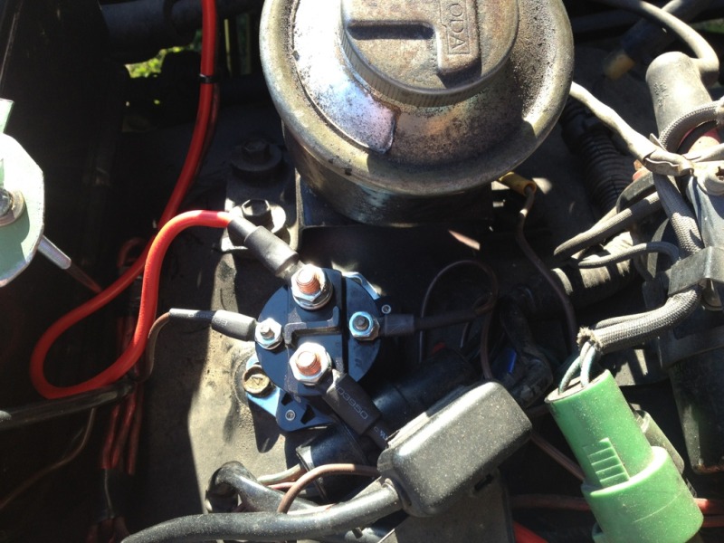

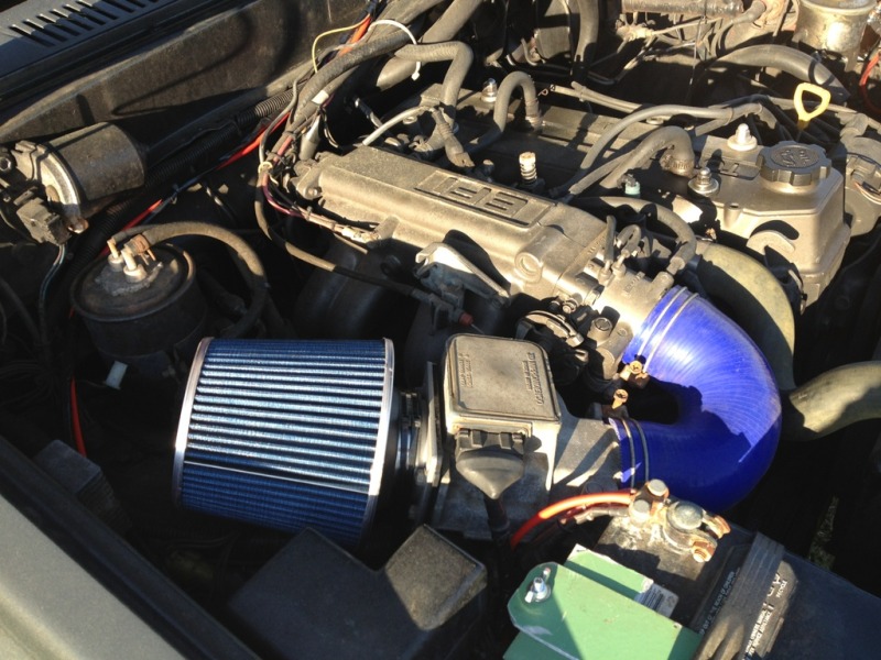

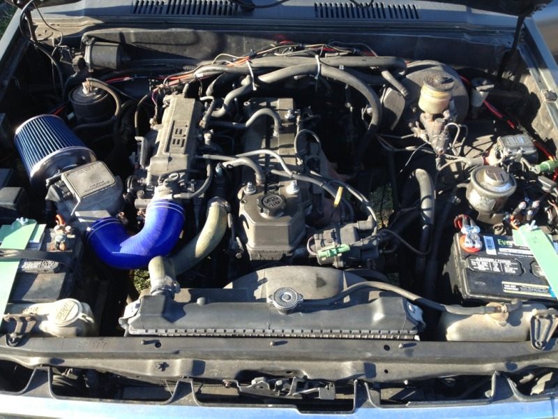

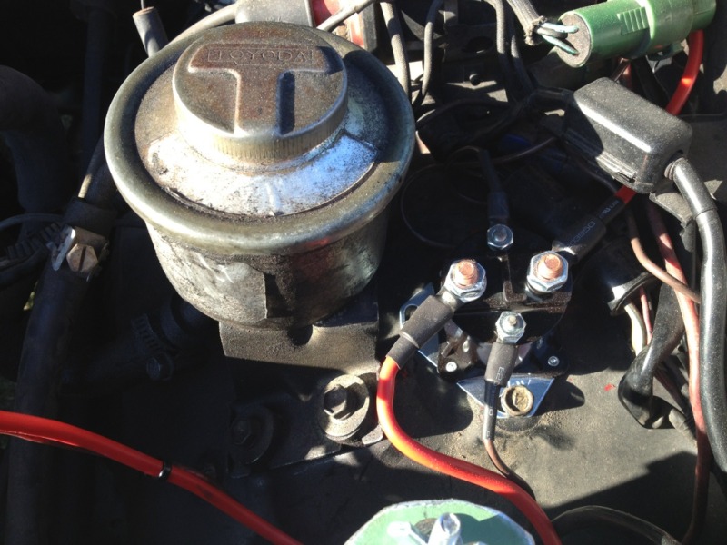

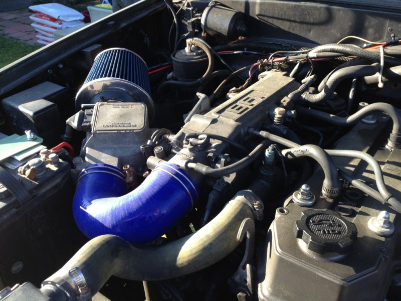

I just finished adding a second battery. Some of you might like to see it. I used a 135* bend off ebay along with a MAF cone adapter. Also went with a 200 amp continuous duty solenoid. Don't mind the battery hold downs, they are temp's till I can get some thicker ones made.

Very nice. Well done. Does it run any different?

Why the solenoid? I thought you could just hook the batteries straight together.
Old Mar 14, 2013 | 05:19 AM
irab88's Avatar
iTrader: (4)
Joined: Jul 2010
Posts: 6,499
Likes: 37
because if you leave your lights on, you won't be able to start your truck if you wire them straight together. with a solenoid, you can drain one battery completely and still start using the other one. (there are other reasons, but that's a good example)

racersg, It runs about the same, maybe the rear window works faster? I have an amp, a few aux lights and 12V outlets. I plan on adding a winch in the future as well. I did this mostly for camping, this way I don't have to worry about the air matress pump or 12V fan killing the starting battery.

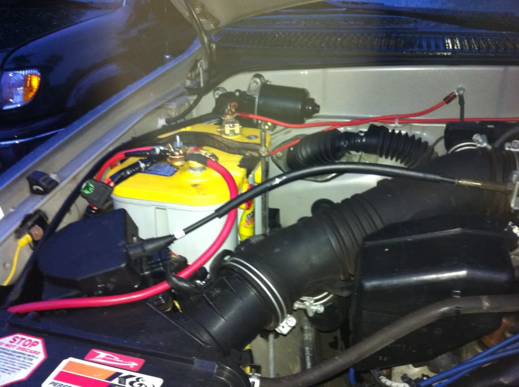

Originally Posted by ThatGuy1295
That looks good. Did you have to relocate anything or was there enough room for the extra battery?

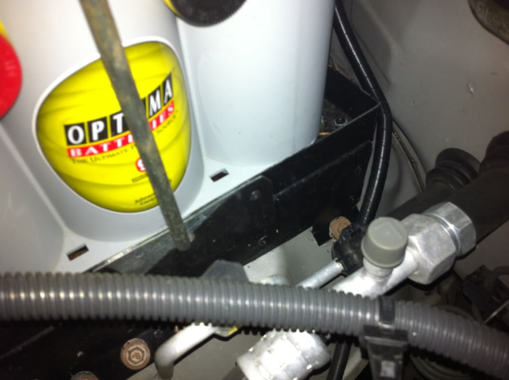

Had to relocate the cruise control closer to the air box. But not to hard to move. My taco doesnt have abs. If it did there would be no way this would fit. And my lights shut of automatically so no need for solinoids or isolators

My understanding is that the batteries will drain each other down when left connected if they are different. That is the purpose of the solenoid. My second battery is actually bigger than my starting battery (I had it already). I have had no problems with this.

Any difference in temps or performance with the relocated and angled intake pipe? Having an idea for this with my 3vze
Nothing noticeable. I would guess the intake temperature would be lower this way (not going across the radiator or engine bay). It is also in a higher position than the stock box.

Ideally same voltage, capacity and charge state when parallel charging. The solar guys go so far as to not even mix batteries from seperate manufacturing lots. Here is a decent link I think sums it up well.
