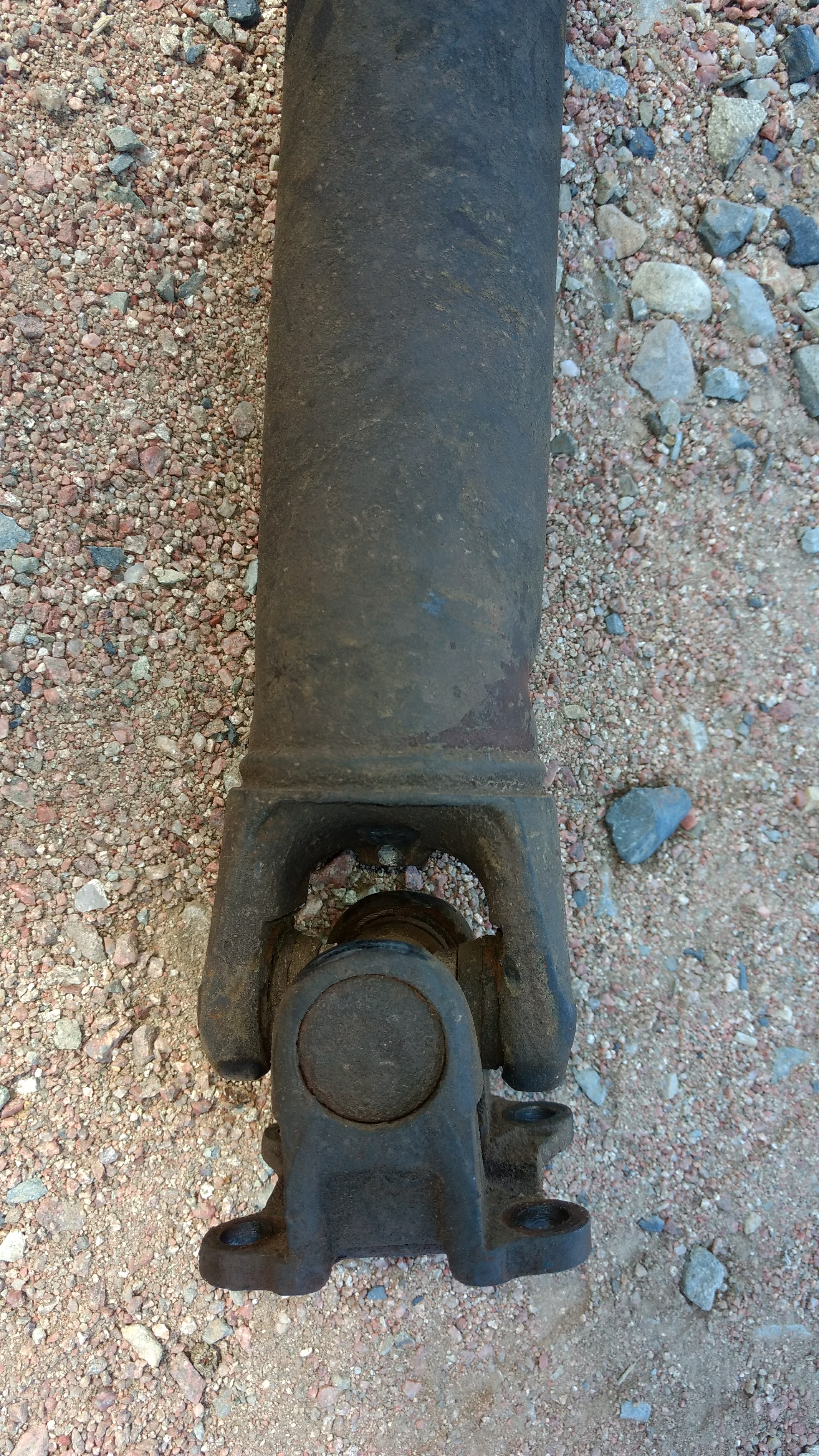

Today while driving on the highway, I noticed a strong vibration at > 45 mph, especially when I took my foot off the brake. If I had known then what I know now, I would have realized that it was the drive shaft and inspected it. In any case, I did not realize this, and pushed the truck a bit in order to get home.
So, going about 50mph, the rear drive shaft (real propeller shaft?) disconnected from the transfer case. You can imagine that it sounded and felt horrible. I pulled over immediately and saw what happened (see pictures).
The truck is an 1987 4runner, 22re, ~320k miles, 33 inch tires, probably ~4" lift.
The strangest thing is that the place where the transfer case attached had one bolt sheared, and it looked like the other 3 bolts were just not there in the first place. Could they have come undone from regular vibration?
Anyhow, do you think I could just replace my u-joints and be fine? Will the rear drive shaft also likely need to be replaced? Also, is it possible that the force of the events could have damaged the rear differential (I attach a picture of it also, seems to be leaking a bit of fluid) or the transfer case?
I've heard that I could maybe unscrew the back end of the rear drive shaft from the differential and drive home on the front wheels using 4WD. Would this work / is this a terrible idea?
Finally, if I get my ujoints and/or driveshaft replaced at transmission shop, roughly how much should I expected to pay?
Thanks greatly
Attached Thumbnails Drive shaft fell out on the highway, need some advice-img_20170506_233155512.jpg   Drive shaft fell out on the highway, need some advice-img_20170506_233117073.jpg   Drive shaft fell out on the highway, need some advice-img_20170506_231111615.jpg   Drive shaft fell out on the highway, need some advice-img_20170506_231228041.jpg   Drive shaft fell out on the highway, need some advice-img_20170506_231141383.jpg

You can remove the rear shaft and drive on the front wheel propulsion.
Looks like that flange was bent when it dug into the road. The shaft might have been bent too.
The coupling bolts likely fell out, one at a time.
Best thing would be to have the shaft looked at by a shop that is equipped to balance them.
It's a perfect time to put a new pinion seal in that differential, and maybe a seal in the transfer output also
Let us know how you do. These trucks are tough, but after 325,000 miles it could use some TLC.

I gotta wonder if those bolts on the transfer case flange were the wrong ones.
I made the mistake of just putting off the shelf bolts in that very same place .
My results were the same but I caught the problem before they fell out completely .
A very scary lesson to learn
I have seen the carnage where the drive shaft digs into the black top lifting the back end of the vehicle
