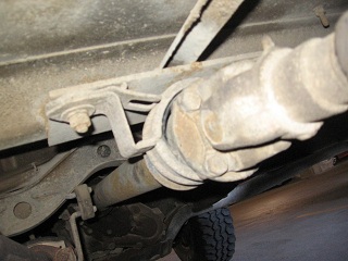

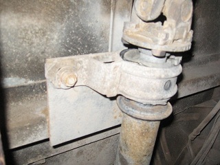

I just picked up a Custom Cab last week. It desperately needs a carrier bearing replaced as the rubber mount is completely gone. Does anyone have a pic of their carrier bearing on the Custom Cab model? What part # did you use? The original part # at the top of page 1 doesn't have a working link any longer.
Old Jun 15, 2012 | 05:12 PM
  #34
Patroller's Avatar
Joined: Aug 2005
Posts: 9
Here is a pic of my truck and a pic of the bearing. The bearing mount is flat, where on the Xtra cabs, the mount is rounded. What have others done to attach the bearing to the flat mount?
Attached Thumbnails Drive Shaft Center Carrier Support Bearing...Affordable replacement-img_7695-smaller.jpg   Drive Shaft Center Carrier Support Bearing...Affordable replacement-img_7694-smaller.jpg   Drive Shaft Center Carrier Support Bearing...Affordable replacement-img_7696-smaller.jpg
Old Jul 4, 2012 | 12:02 PM
  #35
Patroller's Avatar
Joined: Aug 2005
Posts: 9
Here is what I ended up using in the Custom Cab:
http://shop.advanceautoparts.com/web...RPUCVSAMS_____
It was 20% off for the holiday week. You have to cut off the little metal hooks and bend the tabs down so they are flat. Easy mods to make and it bolts right in. The last one was well used so this should last quite a while.
I also pulled the drive flange off the rear of the t-case. The nut was finger tight and it had been spewing oil. This is the 26 spline for the turbo model so it has a different seal than most. Put in a new seal:
http://www.autozone.com/autozone/par...er=136728_0_0_
And I also am changing the t-case oil to a synthetic blend. All should be good to go for a while.
