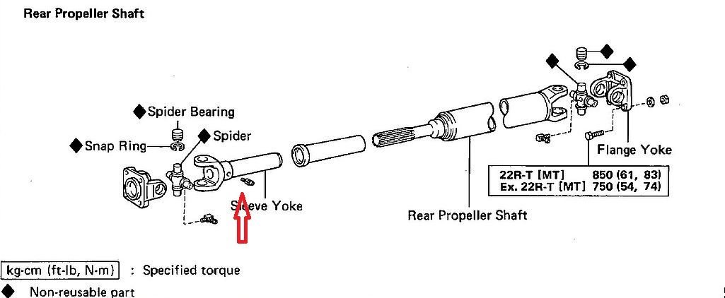

I am pretty sure I used the metric ones. If you can buy one, compare the threads with one of the little bolts. I have a couple of pretty extensive tap and die sets, and that's what I used to check the threads. Found the die that fit the little bolt, and bought whatever number it was.
Worst case, buy a set of each, the standard and metric ones. They're not all that expensive, and see what fits into the holes
Some of the holes are pretty hard to get to, so make sure you've got the right zerts before you go to put them in. There are a few out in the open and easy to get to, so you can finger tighten at first to be sure they go in properly. A real shallow, 1/4 drive socket on an 4 or 6 inch extension will, at least, start the ones that are hard to get to.
You can put some wadded up paper, or small piece of rubber into the socket to make it shallow enough to install the zerts. I made mine shallow enough that the "bolt head" part of the zert was just down in the socket a little bit, and the threads were sticking out almost all the way.
This picture, from the FSM, shows them already installed, but when I bought my 4Runner, there were just bolts in the holes. Note that they show 90° zerts in the spiders. I used 45° ones and they are much easier to get to. Just my experience though. By the way, I am still on the first set of u-joints, and Double Cardans. 177,000 miles so far and still in good shape!
