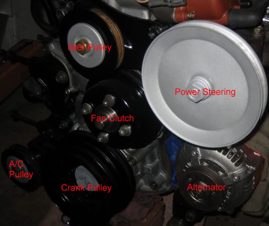

I will give that a try tomorrow. Sorry to be a noob, but which on is the idler pulley? What grease did you use?
Here's a pic of the front. There are 2 that could be checked. The A/C and the Idler, both have a bearing that gives issues, the Idler more so than the A/C. Hope this helps.

Idler Pulley bearing goes out from time to time. I have just always replaced it with a new bearing from the dealership. Its real cheap, 8 bucks I believe. It is a actually very easy to replace too.
