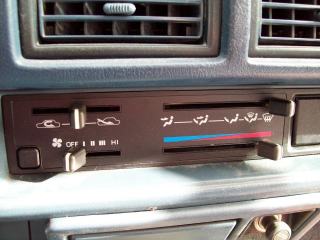

I also suffer from a lack of heat. 1988 that I have owned since 1989. I dont remember the heater ever getting hot, but here in sunny California it is not a big deal. But I wish there was enough heat to defog the inside of the windshield on a cold morning.
I thought the heater core was plugged or the valve was not opening. I moved the heat control lever inside and could see the lever on the valve rotate all the way in both directions. So it is not the cable to the valve.
Then I thought the valve might be bad inside so that it only appeared to be working. I remove the valve. I could open and close the valve by hand. When it was open I could blow air through it. When it was closed I could not. Also ran water throught the valve with a garden hose. There is nothing wrong with the valve.
Then I back flushed the heater core. The water came out as fast as it went in. No junk came out. At first coolant came out then clean water. If you look closely at the picture you can see a good flow of clear water out of the heater core inlet at the firewall.
I did this during the summer. I was hard to tell if I fixed anything because it was so hot outside. Now that it is cold and my windshield fogs up in the morning - it still is not working. I slide the lever to full hot and the fan all the way up, and it takes forever to defog the windshield. I can drive for 2 hours and it will not even get warm. It is not cold, there is a little heat, but I would not even call it warm. A good flow of air blows out of all the vents - it just is not hot. When I switch to the windshield to the middle to the floor vents or the combinations, a good flow of air comes out of all the vents.
As for the history, this truck has always been cold blooded. If it is 100 outside and I am in stop and go traffic, the temp gauge sits just below the middle. 1 1/2 years ago I put in a SR5 cluster and the gauge is in the same position. So it is not my gauge. This truck has never over heated - I don't think it can. In 19 years I have never seen the gauge go past the middle. Weird truck.
The coolant level has always been up to the brim in the radiator and the overflow tank is also full. I have run the engine when it is hot with the cap off just in case there was any air in the system. When I removed the first hose from the valve to the heater core coolant came out. When I flushed the core a bunch of coolant came out. So I know coolant is getting into the core. Weird cold blooded truck - but it has always been that way.
Old 12-22-2008, 05:09 AM
Bushwhacker's Avatar
Join Date: Mar 2007
Location: Wales, G.B.
Posts: 71
Received 0 Likes on 0 Posts
Check the flap that covers the heater core housing under the dash, the flap that shuts off the hot airflow, is opening properly. It's probably stuck or the cable is kinked.
Old 12-22-2008, 01:12 PM
Tool Pants's Avatar
Join Date: Dec 2006
Posts: 151
I dont think there is a flap for the hot air flow. I think that is what the valve in the engine compartment is for, and the reason for the lever with the blue and red indicator under it. When I slide that lever back and forth all it does it to open and close the the hot water valve in the engine compartment.
When I move the lever with all the vent icons I hear flaps moving. But those are flaps to direct the air flow to different parts of the vehicle.
Attached Thumbnails Does anybody know how to unclog a heater core-my-heater-levers-small.jpg

no, there is most definately a flap; you can hear it "flap", or at least I can, when you slide the temp control from cool for warm relitively quickly
couldn't tell yah where it is, but if you pull the dash apart and look at the back of the temp control unit, you'll see 2 cables coming from it; one go's to the heater valve, the other go's to that flap

I know what a mechanical flap that opens and closes sounds like.
No flap noise when I slide the lever for the heater, only the valve in the engine compartment moves.
You people are telling me that there are 2 cables that are supposed to move with that lever. 1988 pickup with no air con.
I hate working under a dash. But I will look for a second cable.

Just remove the glove compartment section and you should be able to see where the operating cable goes.
