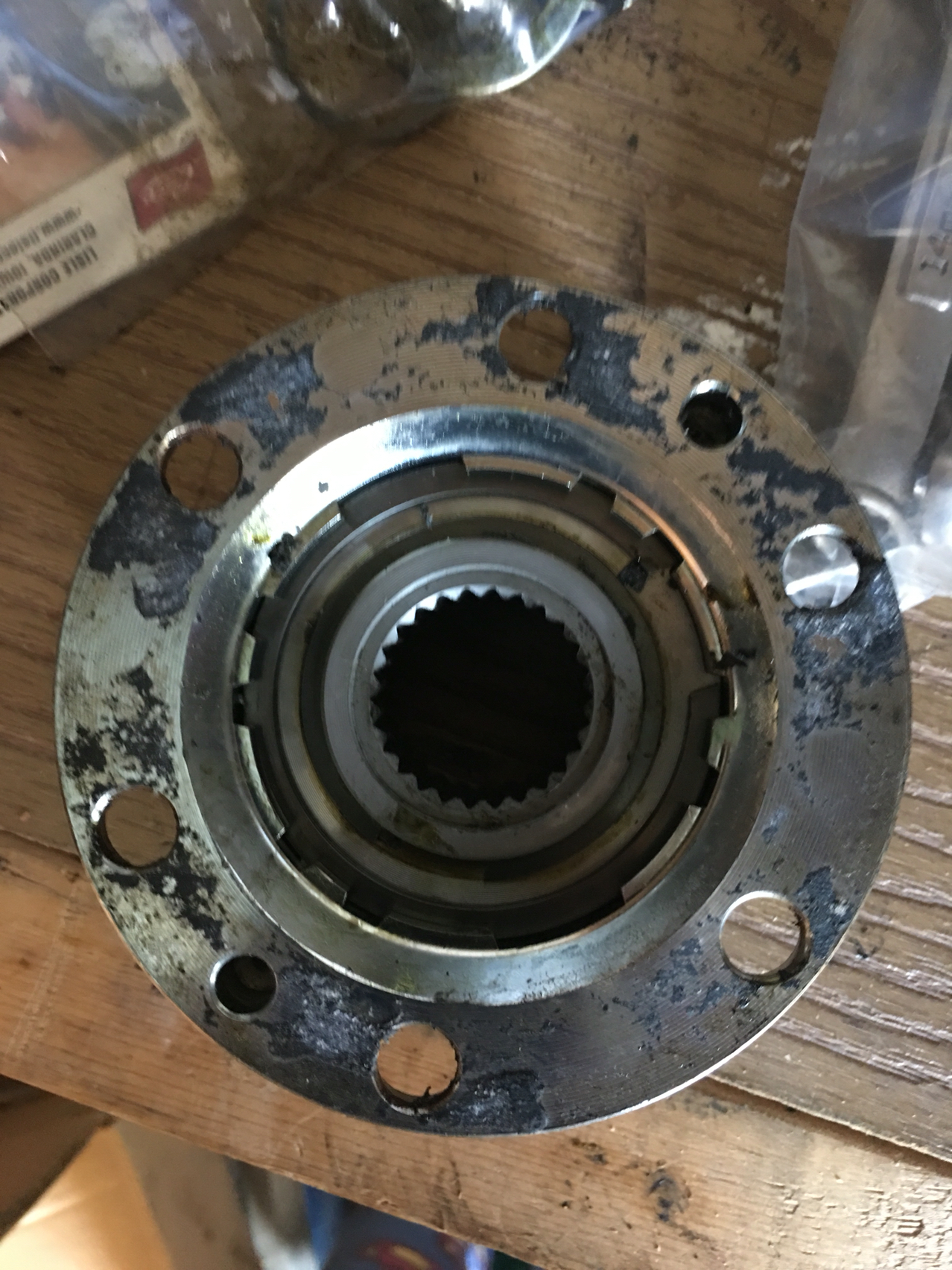

Do I grease this after cleaning? Or replace anything?
These bearings are tough. I'm doing a bearing replacement. Inner/ outer.
Attached Thumbnails Do I grease this after cleaning? Or replace anything?-photo549.jpg   Do I grease this after cleaning? Or replace anything?-photo236.jpg

MP grease on all the sliding surfaces, according to the FSM.
those pics are not pics of bearings.
what bearings? you mean wheel bearing replacement?

Originally Posted by osv
those pics are not pics of bearings.what bearings? you mean wheel bearing replacement?
This is just part of the job to do the bearings.

gotta pack the bearings themselves, then grease the internal sliding surfaces of those parts, like mudhippy said.

Thanks. I put some grease on both sides of the hub. Thanks for the link also.

Download the 88 FSM <-- Right click, then Save target as. It's on pages FA-47 & FA-48
