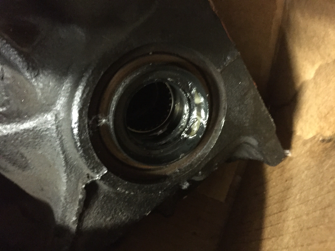

If you don't have add then you can run either front third member. The add diff is a little better because it has needle bearings in the carrier like this:

But you have to install another oil seal on it so that both sides look like this

Yeah it's an add front but I put a non add front into my add setup by machining it. Check out my build thread and you can see what I did. You don't need to machine anything by using an add diff in a non add. You just have to put in a $7 axle seal on the add side of the diff and reuse your axle tubes and axles.
In fact I didn't have to machine it, I chose to because it is an improvement to have those needle bearings.
