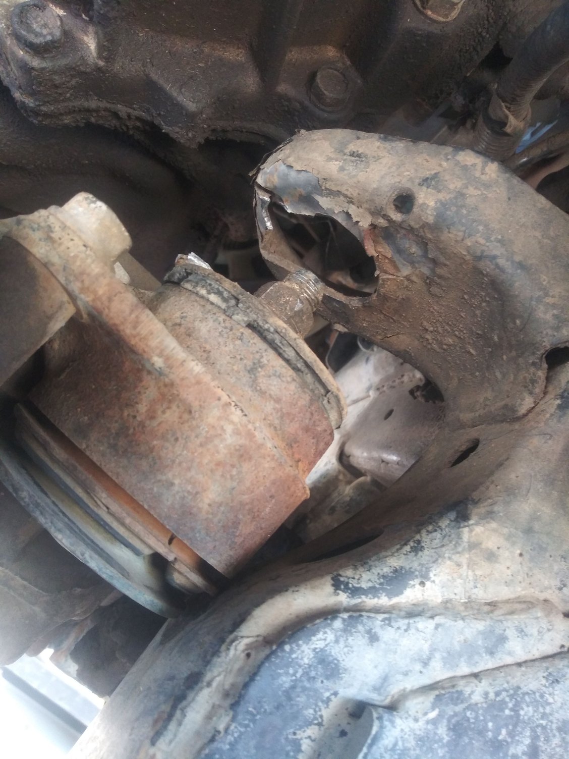

Dif mount broke..
Old Aug 16, 2019 | 06:41 PM
Dom91's Avatar
Joined: Jun 2019
Posts: 43
Dif mount broke..
Any suggestions lol....
Old Aug 16, 2019 | 07:19 PM
millball's Avatar
Joined: Aug 2013
Posts: 4,264
Likes: 683
From: Southern Arizona
Weld a piece of quarter inch plate there with a suitable sized hole drilled in it. Bolt it back up.
