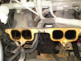

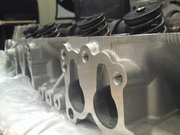

SO..... i'm gonna post some pics, I have already started the big job, been into it about 2 months now on the weekends. I have removed the exhaust mani, removed upper intake and lower intake, (btw, that dam allen key head bolt took me about a week to get out) , removed the head!
Now here is where i have a question? what should the coolant holes on the bottom of the head look like, i mean should they be identical to the coolant holes on the piston block? I will post some pictures...
any feedback would be helpfull....

so the first picture is the block and the coolant holes are nicely formed, perfect holes , no imperfections, Now the picture on the right (crappy pic because i can't upload more thazn 48kb!) is a pic of the head upside down on a milk crate so i could clean it. You can barely make it out, but the coolant holes there are very rough and NOT perfect.
So, shouldn't those holes when they line-up with new gasket in place, shouldn't they be identical? I mean won't it just leak again as soon as i fire it up?
Wondering if the new gasket will bridge the gap and keep the coolant in those holes.
Or am i screwed, and should starty looking into a new head?
is it possible to repair, or weld those holes back to the matching size on the piston head?
i'm sort of stuck right now.....

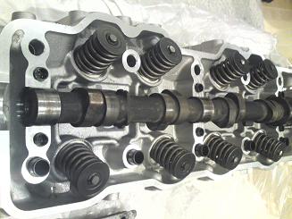

so i got a new head, looks great! nice and shiny! put all the studs in and used loc tite on the ones which were permanent on my old head...i pretty much prep'd the new head the same way my old head was taken out. Turns out one of my valves was stuck shut and i was only running on 3 cylinders for quite some time. lol wow...so a new head and valves and i'll be super happy if i can get it all running again.
pictures coming soon...

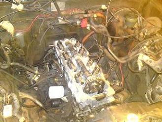

pictures of job
So i got the new Head and have installed it on the block, all went well.
****Tip***for anyone doing this job themselves for the first time....
I would reccommend the 3M scuff/cleaning ball. It was 22 bux for this drill bit type thing that had a scuff ball on the tip and it made it super easy to clean the pistons. Also thank god for Carb Cleaner, works great.

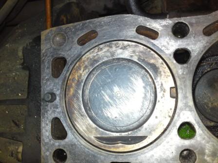

After removing the old head the pistons were completely black. It took me 3 weekends to get everything clean, and i still could've cleaned more.
HAppy Holidays to all!!

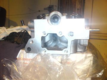

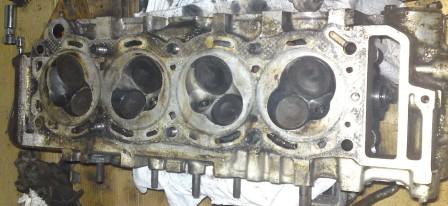

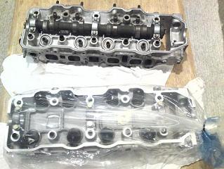

some pics!
here is some pics of the old head vs the new head
Attached Thumbnails deejaysterling's_1987 SR5_4runner  Head Gasket Replacement-new-head.jpg   deejaysterling's_1987 SR5_4runner  Head Gasket Replacement-new-head-open.jpg   deejaysterling's_1987 SR5_4runner  Head Gasket Replacement-new-head-side.jpg

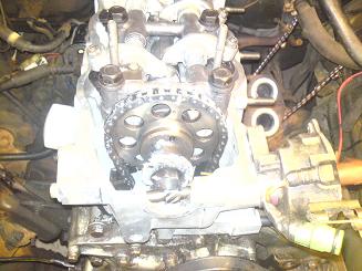

went out today, removed the rocker cover and pulled the EFI relay, then disabled the spark system. soon realized that finding TDC by myself is hard. so gonna get some help tomorrow to get it to TDC on compression stroke.
I wAS very tempeted to go get a remote starter so i didn't need help to get to TDC. But i can wait for help.
on, second thought, i think it is easier to remove the fan shroud and put ratchet in the main pully/crankshaft and rotate the engine by hand to find TDC (then i don't need a helper)

Received 0 Likes on 0 Posts
*********update**********
after adjusting my valves to .011 and .008
did another compression test
1st - 97 short test 120 long test
2nd - 105 psi 117 psi
3d - 122 psi 140psi
4th - 90 psi 94 psi
...much better on my middle two cylinders. before i had nothing and now it's over 100psi, still a little concerned about the compression level overall. The specs call for minimum 128 psi.
- starting real cold outside
- when i turn the ignition i wait 10 sec for fuel, then start......it cranks better now that i adjusted valves, sounds like it wants to fire, but yet i still i can't get her purrrr'in.
I only let it crank for about 8-10 seconds b4 i started to smell something burning. COuld have been exhaust as my rear window and side windows are down, and the access panel to the fuel tank is off right now.
I'm gonna give the battery a fresh charge and heat up the garage b4 i start it tomooroow. Was thinking of using some liquid fire starting fluid.
If it still no start, thinking maybe distributor may be off a tooth?...hmmm

So , i'm thinking i'm off a tooth on the distributor, and maybe i'll have a go at that tomorrow. It's -14 C here and my fingers are numb.

SUCCESS!! i went out on the weekend and adjusted my distributor to move it it one tooth forward.
Started it up, and BAM! perfect! sounding nice! brand new head, and i can feel the power in 2nd gear, (my old head had a stuck valve and i was operating only on 7 valves)
After taking her around the block i realized my ebrake is seized and i have a bit of valve lash noise coming from my rockers. So i will re-adjust valves when i get a chance....Loud valve lash is normal right?
i mean it's not terribly loud that you can hear it outside the truck, but lift the hood and u can hear it.
I'm going to go get some new oil, coolant flush and oil filter. Give her a little tune up and i'm back in buisness!
