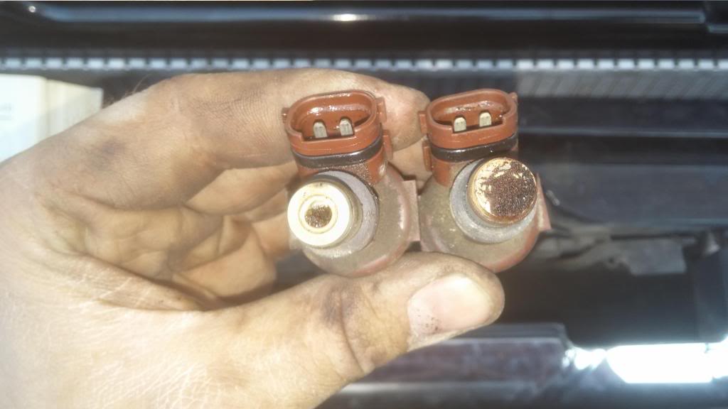

I was confident it was an injector problem, but i would have never of suspected it was this bad (no.3 is the right one.)-
changed the filter the other day after all this had started, must have gotten past the old filter… The whole thing was full of dirt.

Just to close this thread out, installed the flamethrowers today, smooth as silk idle, and tons more usable power everywhere. Super impressed and happy with the results!
