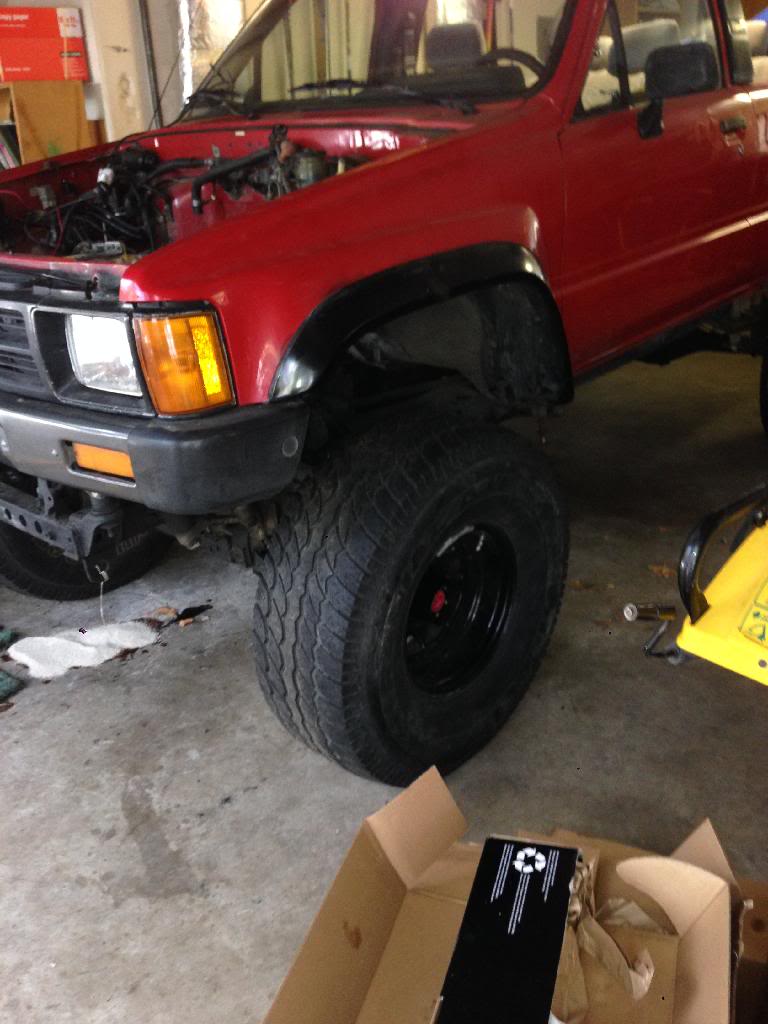

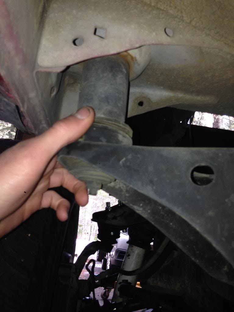

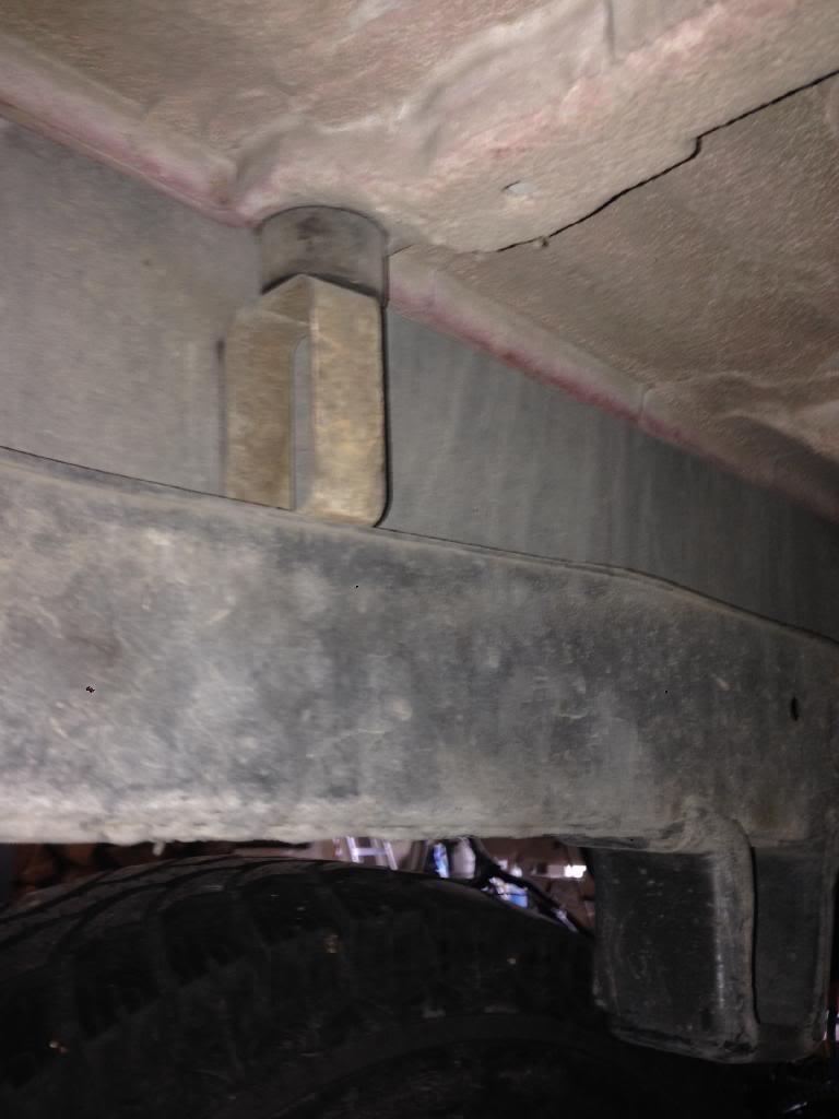

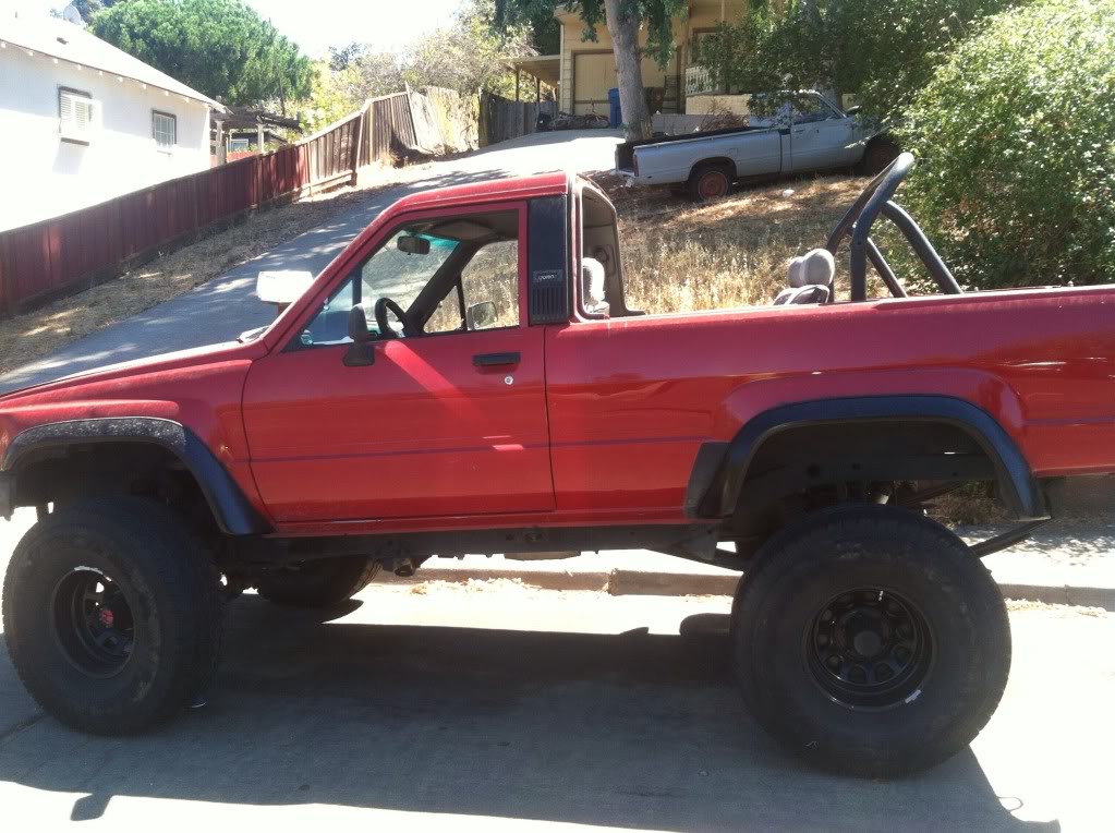

Did my BJ spacer kit, sway bar diff drop. Almost leveled out but had a few more questions. I'm thinkin of pulling an add a leaf cause I know when I drop my engine in it'll sit the front end down more. Anyways so she sits on 35's and with the engine swap I ain't buying 33's plus it's already geared for 35's. Here's two pics of my body lift they're 3" blocks. And a pic of my leaf springs.
---If I take this body lift off, will it clear these 35's ok? Or am I wasting my time even thinking about it?

The truc how it currently sits. Name:  B238C674-9858-4941-B0F1-0D3143F0D1AC_zpsl4j4ex4r.jpg

Never mind. I looked into it more. My 3" suspension isn't enough to clear 35's nice enough ill just leave the body lift :-(

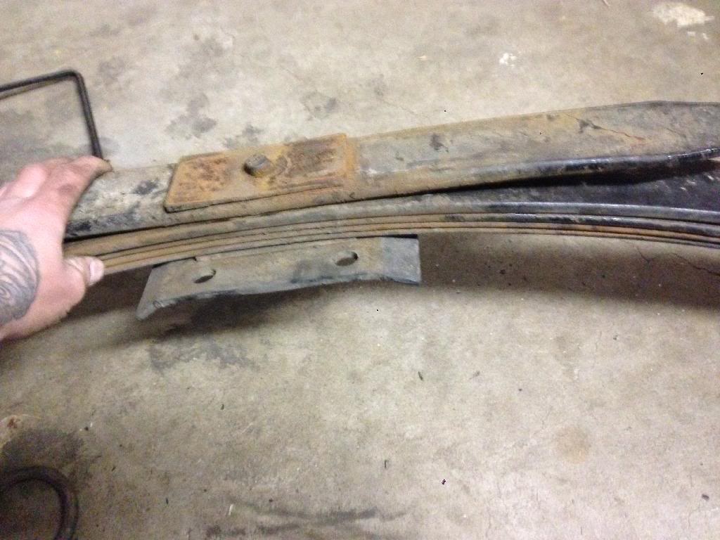

Can I even pull a leaf spring on this. It's got that bolt through the middle, it's got a not on top but when I turn it. The whole thing spins. I've tried bangin on it and holding the other side. No luck. I don't feel like this is even an add a leaf. Maybe just the block is the rear lift

if you take those plates off there is a center bolt you can remove and then remove leafs and then reolace the bolt. you have a 3" body lift, and it looks like someone put a different leaf pack in the back because those dont look like factory toyota springs.
Thanks for the reply. And deffinently not factory springs. A bit different from my 88. My problem is I can't remove the plates. The bolt on top of the spring seat turns the whole bolt through . Should I try to hammer a big tapered punch on the bottom plate to remove it?

yes that bottom plate should come off and theres a nut under there

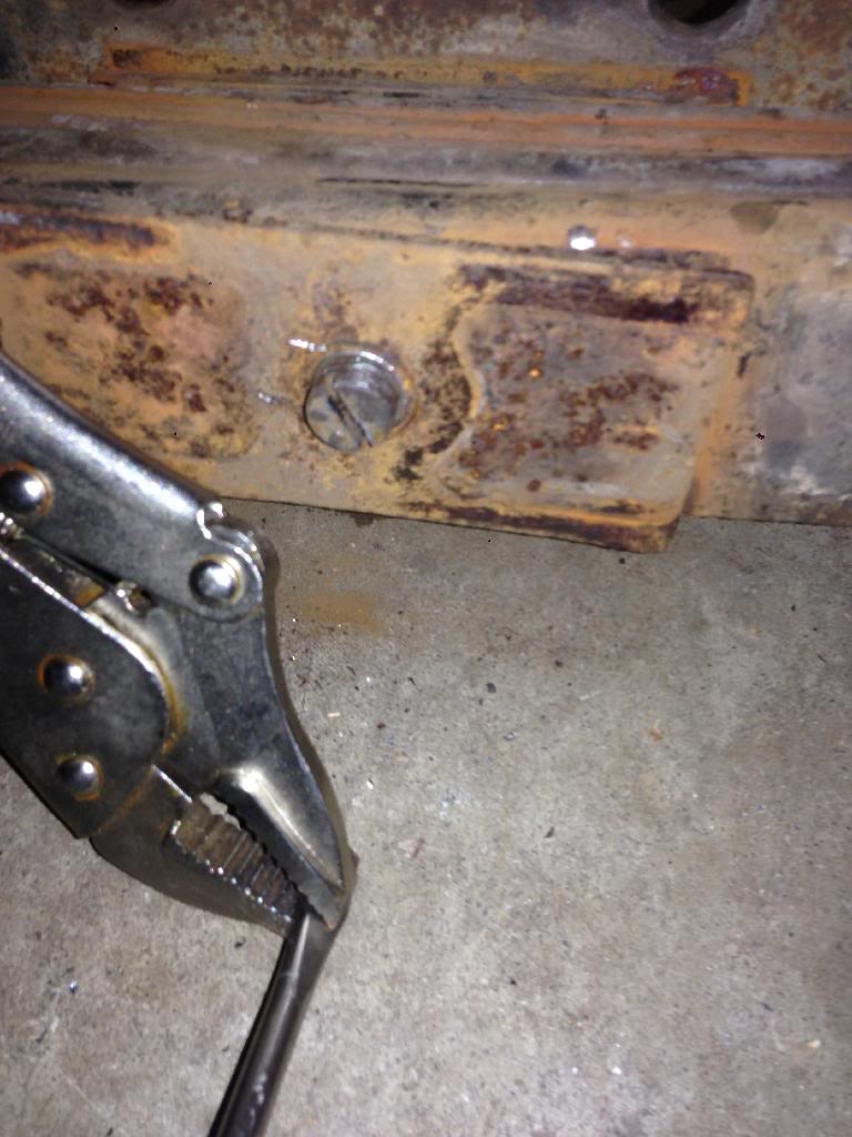

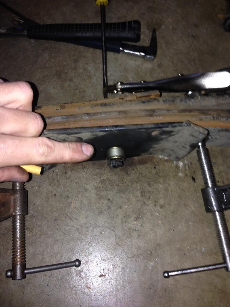

Well not having much luck. Tried vice grips torching, soaking in pb blaster. If I cut this nut off, will I be able to buy a replacent? Name:  4AA0382C-23FA-409A-91B4-228DF12B463A_zpsi6tw4nes.jpg
Old 01-01-2014, 02:51 PM
Moto260's Avatar
Join Date: Feb 2013
Posts: 224
Received 0 Likes on 0 Posts
Cut the bolt. Worked great lmao.

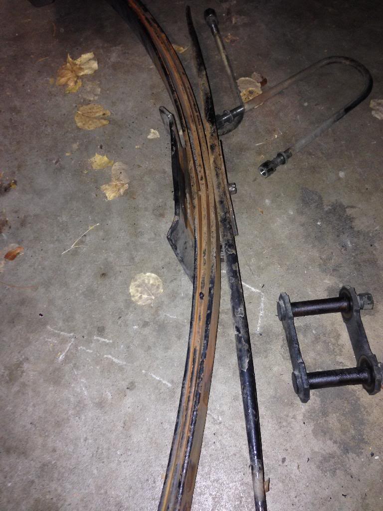

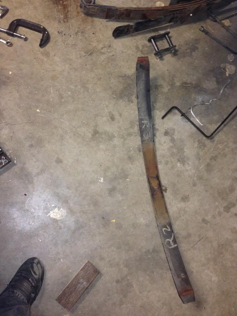

So hopefully this is the proper way. This is how I'm doing it. Please correct me if I'm wrong. I'm taking this leaf out.
This is what it looks like with that leaf out.
This is the leaf that I've pulled out

I had a 3" susp lift and 36s on my 85. big hammer and an angle grinder are your friends
