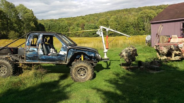

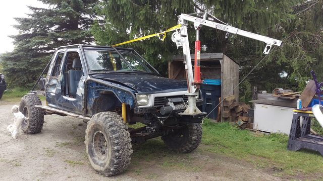

I mounted a bed crane on a 2" receiver to use on the front of the truck.

Sweet! I like the idea of the atv winch on there.
That's cool I like it !
